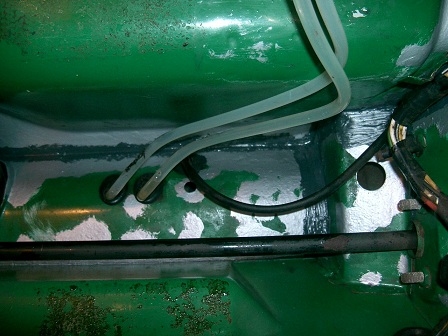

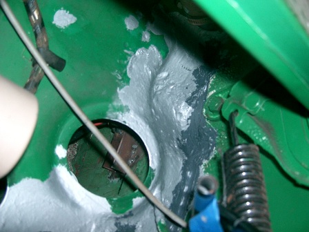

Continued working on the area under the gas tank and the front trunk attachment point. Areas were cleaned, rust treated with ospho, followed by two coats of rust bullet and new seam sealer. Note to self...when working upside down applying opsho with a hollow acid brush, do not hold the brush in your mouth while getting out from under the dash. (IMG:style_emoticons/default/dry.gif)

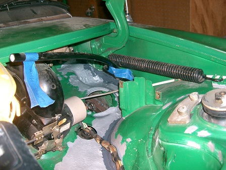

saigon71   Progress continues at a slow, but steady pace. Co...   Jun 12 2011, 09:15 AM
saigon71   Put the tank back together with a new Foley fuel s...   Jun 12 2011, 09:26 AM
saigon71   I wasn't in the mood to spray primer yesterday...   Jun 12 2011, 09:34 AM

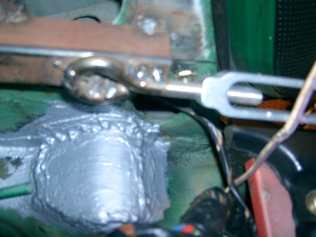

saigon71   Finished up the repair of the front hood cable att...   Jun 22 2011, 03:37 PM
