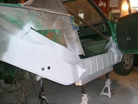

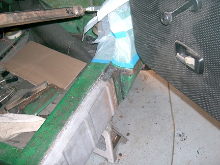

Finally got my new inner long welded in with doubler plates on all seams. Verified the incline of the new long with an incline gauge (with the car level) following Jeff Hails build thread. Door operates well! Entire inner long has been coated with rust encapsulator.
Still have a long way to go but I am hoping that this was the toughest part.

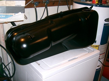

Put the tank back together with a new Foley fuel sock. The threads were a little gummed up from the red coat the shop used to seal the tank, so I had to run a tap through the holes to clean them out. The fiber washer on the small line was in bad shape so i picked one up at the local ACE hardware and modified it to fit.

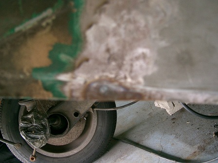

Flash rust is a bitch! (IMG:style_emoticons/default/mad.gif) I understand that it has been humid and that my washer & dryer are in my garage, but this is ridiculous. This area was freshly welded just last week:
I took a look at all the other bare metal...it was happeneing everywhere. Time to treat with ospho and get some primer on:
