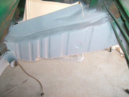

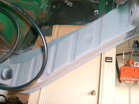

I wasn't in the mood to spray primer yesterday, but I must admit that finally seeing these areas a single color was motivating. Primer - inner long:

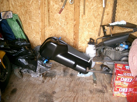

This project has become bigger than my one car garage can handle...teener parts now have a strong foothold in my shed as well:

saigon71   I wasn't in the mood to spray primer yesterday...   Jun 12 2011, 09:34 AM
saigon71   Shed - continued:   Jun 12 2011, 09:38 AM
