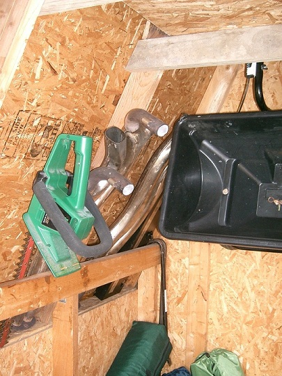

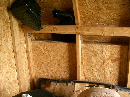

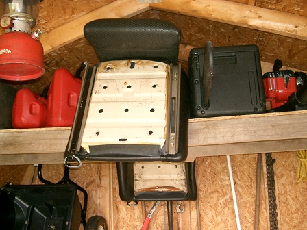

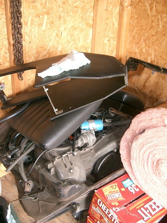

saigon71   While waiting on the inner "ply" for the...   May 15 2011, 06:32 PM
saigon71   Cutting - continued: Luckily, it looks like the ...   May 15 2011, 06:42 PM
