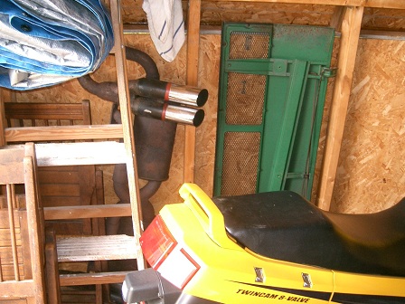

saigon71   I wasn't in the mood to spray primer yesterday...   Jun 12 2011, 09:34 AM
saigon71   Shed - continued:   Jun 12 2011, 09:38 AM
