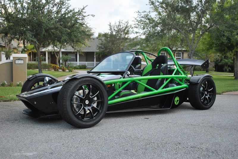

I built the lightest 914 in the history of mankind. ![]() ![]() ![]() ![]() ![]() ![]() ![]() ![]() ![]() ![]() ![]() ![]() ![]() ![]() ![]() ![]() ![]() ![]() ![]() ![]() ![]() ![]() ![]() ![]() ![]() ![]() ![]() ![]() ![]() ![]() ![]() ![]() ![]() ![]() ![]() ![]() ![]() ![]() ![]() ![]() ![]() ![]() ![]() ![]() ![]() ![]() ![]() ![]() ![]() ![]() ![]() ![]() ![]() ![]() ![]() ![]() ![]() ![]() ![]() ![]() ![]() ![]() ![]() ![]() ![]() ![]() ![]() ![]() ![]() ![]() ![]() ![]() ![]() ![]() ![]() ![]() ![]() ![]() ![]() ![]() ![]() ![]() ![]() ![]() ![]() ![]() ![]() ![]() ![]() ![]() ![]() ![]() ![]() ![]() ![]() ![]() ![]() ![]() ![]() ![]() Group: Members Posts: 134,644 Joined: 3-February 03 From: Jacksonville, FL Member No.: 222 Region Association: None |
I found this on another forum I belong to. The car is a one off but the owner and builder want to start production. The car is now in West Palm Beach FL. Have a look...

URY914 As you can see the engine is not complete. Mar 23 2011, 06:16 PM

jimkelly except for the need for a radiator - there are man... Mar 23 2011, 06:57 PM

except for the need for a radiator - there are ma... Mar 23 2011, 07:19 PM

nathansnathan I guess it does have the fan housing. I was lookin... Mar 23 2011, 07:25 PM
URY914 He should run Jake's DTM fan. Mar 23 2011, 07:30 PM
Rand
I was also wondering about cooling. Being in ope... Mar 23 2011, 07:31 PM

I'm not sure the rear wing actually helps wit... Mar 23 2011, 07:43 PM
URY914 That chickenshit wing needs to be up in the airflo... Mar 23 2011, 07:32 PM

John I say put a 3.6 on there and it would be a ROCKET... Mar 23 2011, 07:47 PM

dflesburg who can tell me what the rear suspension parts are... Mar 24 2011, 09:22 AM

wobbletop
who can tell me what the rear suspension parts ar... Mar 24 2011, 10:25 AM
Jake Raby I had a phone consultation last week with a person... Mar 24 2011, 10:51 AM

RFoulds I guess its just me, but I dont like it. the firs... Mar 25 2011, 10:16 AM
turnaround89
:agree:
What they managed to do is really amaz... Mar 25 2011, 01:18 PM

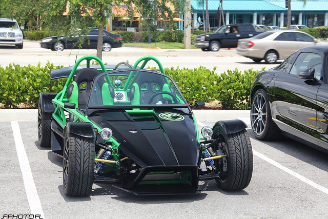

URY914 RE: Ariel Atom clone with a Type IV has been built May 1 2011, 06:14 AM
URY914 RE: Ariel Atom clone with a Type IV has been built May 1 2011, 06:15 AM
URY914 RE: Ariel Atom clone with a Type IV has been built May 1 2011, 06:17 AM
URY914 RE: Ariel Atom clone with a Type IV has been built May 1 2011, 06:18 AM
Jake Raby Wow!!
But PLEASE do something about that e... May 1 2011, 06:38 AM

URY914 That wing is a handy place to set your tools on wh... May 1 2011, 07:11 PM
URY914 The guy has it running.........

shuie Any idea what he is using for bearing carriers in ... Nov 21 2011, 04:27 PM
URY914 Project Update: The owner recently posted that he ... Nov 21 2011, 07:07 PM

poorsche914 The guy that actually built the car is still doing... Nov 22 2011, 04:54 PM
golftdibrad
[quote name='golftdibrad' post='1576822' date='No... Nov 22 2011, 04:57 PM
shuie
Its Pontiac sky parts. The a-arms, hubs, upright... Nov 22 2011, 05:03 PM
