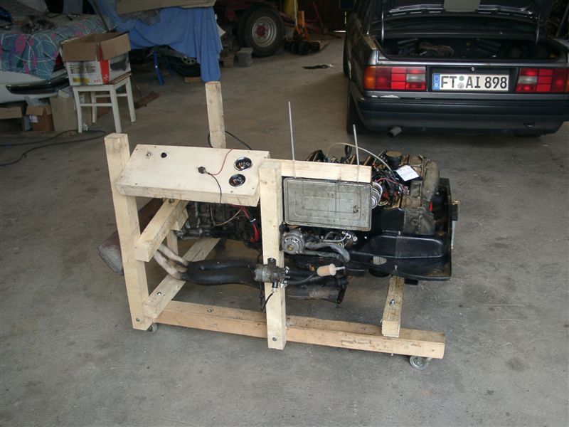

Nice score on the parts car. BTW, something like this is what I was talking about for a simple engine run stand: http://lainefamily.com/EngineStandProject.htm

QUOTE(dheming @ Jun 13 2011, 02:55 PM) *
You call that simple? (IMG:style_emoticons/default/biggrin.gif)
Here's a pic I had saved, he's got the fuel injection partially attached to it, too, 914 stuff there.
