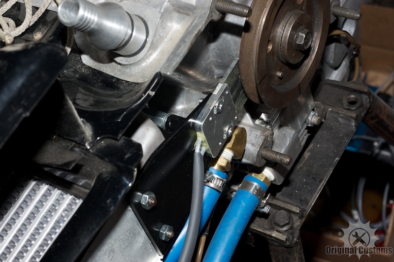

My plans are to utilize it w/ a Ford /4 EDIS setup, but thats getting a little ahead of myself. Right now Im working to mock up my oil cooling configuration and the desire is to go full-flow but the current mount position for the sensor obstructs that ability.

Here's the HALL sensor mount that I used on Rob's engine. It's got magnets epoxied into a stock A/C pulley. The plate mounts securely to the oil cooler studs. Something similar could be used to mount a VR sensor (the one in the first post of this thread).
