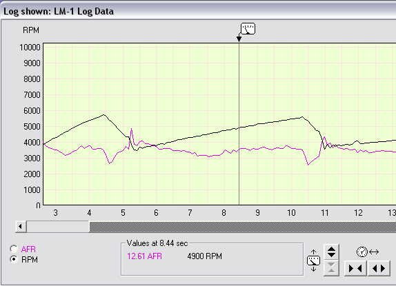

Yep. That's the one. I just got the rpm-converter working tonight (first one was bad - they Fedexed me a new one). Here is a partial shot of the log viewer. Don't judge my tuning yet - I just got this thing hooked up. It's great. You can see that I'm a little lean below 3,500rpm, a little rich from 4,400-4,700, and just a hair lean from 5k and up (It was WAY rich the first go-around and I overcorected a hair). I'll fix that in the morning. You can also see that I'm going rich on over-run between shifts and need a little more acceleration enrichment (notice the little spikes where the rpm's are at the lowest - that's where I mashed the throttle after a shift. Those spikes were huge 10 minutes earlier). This graph shows a first and second gear run (going up a hill). You don't get to see the rest of the graph because someone would do the math and give me a lecture. (IMG:style_emoticons/default/happy11.gif)
I highly recommend the aux-in cable for logging rpm (throttle possition would be nice too - I might try to hook that up). Trying to drive and make mental notes of mixture at give rpm just wasn't very effective. And things like acceleration enrichment happen so quickly you can't see it all happening in real-time. Dump it to the computer though, and it's all right there for your chin-rubbing pleasure. I love this thing!
