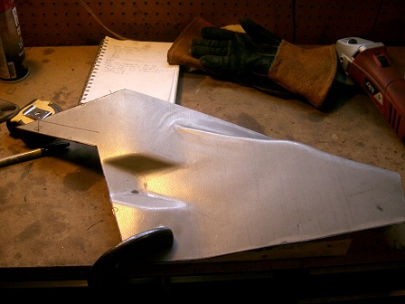

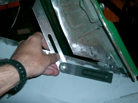

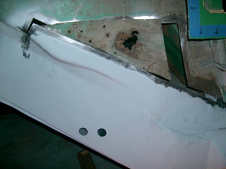

Got a decent amount done last weekend. Installed a section of the Restoration Design upper wheelhouse panel. I didnt need a whole lot of it, but I did need the indented section. Indexing this piece was a challenge. All I had to go off was matching up the curve on the indented section of the piece I cut out to the new panel and a bevel gauge to get the proper pitch of the rise. I opted to weld a bolt on to the piece so I could hold it in place and tweak it slightly while getting it tacked into place. The panel seemed to shrink along the bottom edge while tacking it in place, so I had to bend the back of it out and trim it down for a flush fit. I ended up with a non-weldable gap where the lower wheelhouse meets the original metal, so I had to cut up a small filler plate for this area.

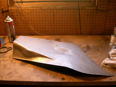

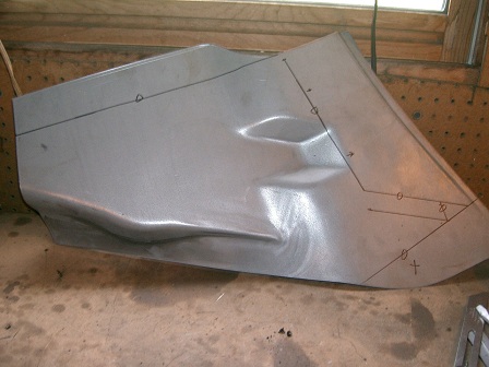

saigon71   For the front firewall patch, I opted to make a te...   Jul 20 2011, 02:56 PM
