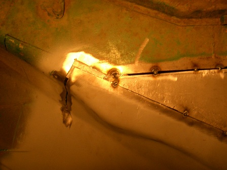

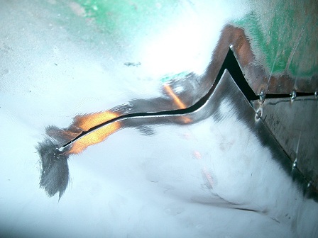

saigon71   Finished reinforceing plate: Cutting back end of...   May 8 2011, 07:17 PM

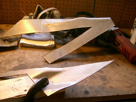

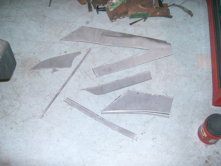

saigon71   While waiting on the inner "ply" for the...   May 15 2011, 06:32 PM
saigon71   Cutting - continued: Luckily, it looks like the ...   May 15 2011, 06:42 PM

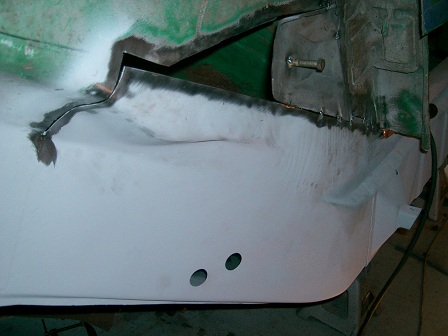

saigon71   Fabrication - continued: Finally finished the fr...   May 15 2011, 06:49 PM

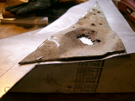

saigon71   Found another large spot of rust where the front t...   May 17 2011, 07:23 PM

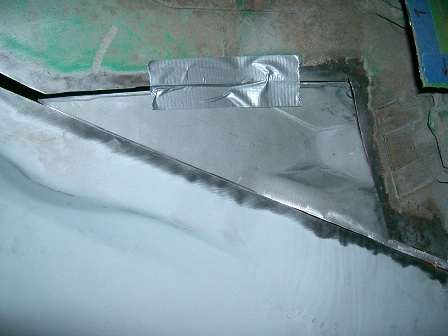

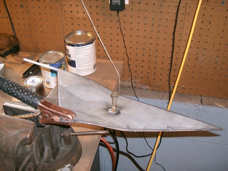

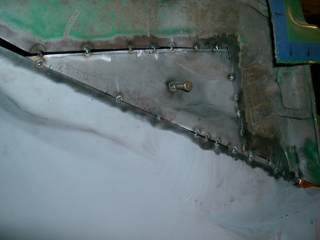

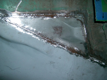

saigon71   Ended up with a bit of a mess where the floorpan m...   Jul 20 2011, 02:47 PM
saigon71   Outer firewall patch:   Jul 20 2011, 02:52 PM
saigon71   For the front firewall patch, I opted to make a te...   Jul 20 2011, 02:56 PM
