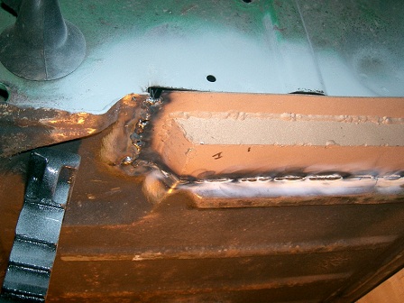

Finally got my new inner long welded in with doubler plates on all seams. Verified the incline of the new long with an incline gauge (with the car level) following Jeff Hails build thread. Door operates well! Entire inner long has been coated with rust encapsulator.
Still have a long way to go but I am hoping that this was the toughest part.

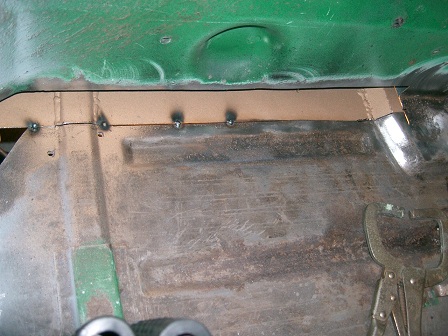

I was also able to get the rear chunk of floorpan (previously made) welded into the passenger side floor. After trimming it up a bit, it fit quite well! (IMG:style_emoticons/default/aktion035.gif)

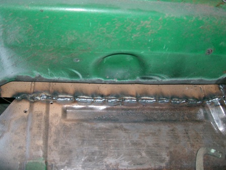

saigon71   Zipped up the seams on the replacement floorpan pi...   May 17 2011, 07:10 PM

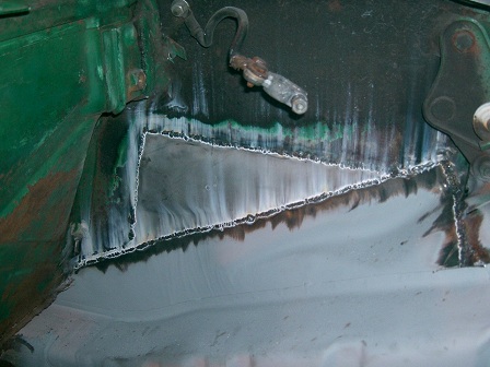

saigon71   Outer firewall patch:   Jul 20 2011, 02:52 PM
saigon71   For the front firewall patch, I opted to make a te...   Jul 20 2011, 02:56 PM
