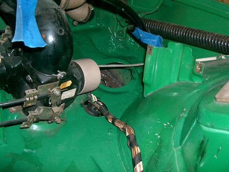

saigon71   Finished up the repair of the front hood cable att...   Jun 22 2011, 03:37 PM
