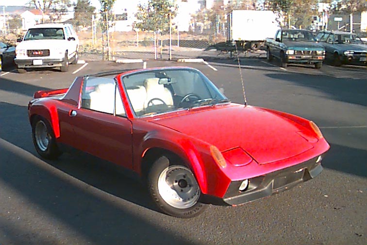

Centerline used to have 4-lug rims that were wider than stock and the perfect offset for flared cars!
Here's my car when i bought it with 7x15 running 225 tires.
