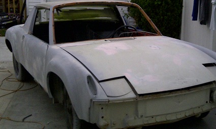

This weekend I was able to get the drivers side ready for a send coat of primer, hopefuly that will be the last. I also started on the front and rear hood. Sometines this week I will prime the ehole car inside and out.

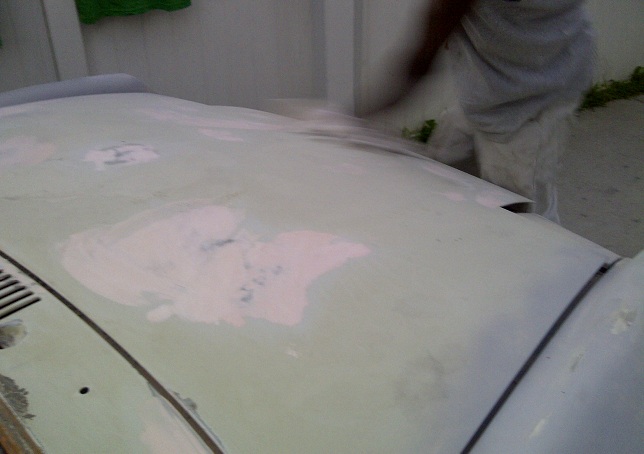

ppetion   I have done quite a bit of work in the last few da...   Jul 27 2011, 01:08 PM
Andyrew   Pin holes suck :) After sanding filler I like goi...   Jul 27 2011, 01:24 PM
ppetion   Pin holes suck :) After sanding filler I like go...   Jul 27 2011, 01:34 PM

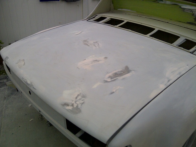

ppetion   I spent about 6 hours today, sanding and fixing sm...   Jul 31 2011, 09:08 PM
