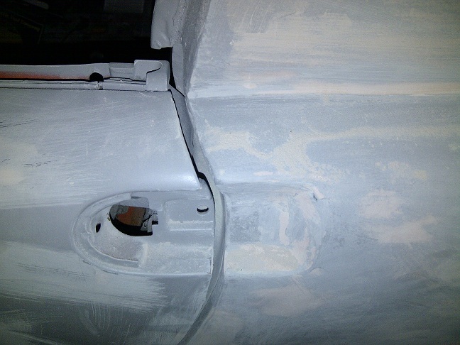

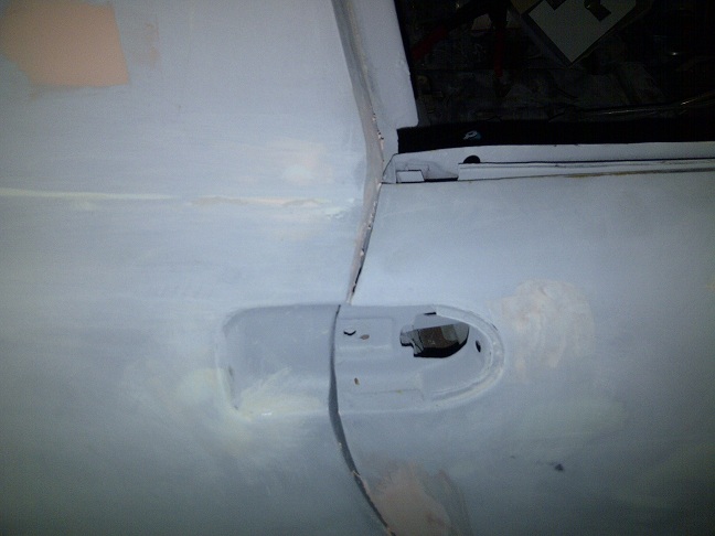

I also noticed the door gap on the pasenger side pillar is different than the driver's, However they are both nicely lined up by the fender area. the doors came from my donnor/ parts car and it seems like they came off 2 different cars, the inside paint didnt match. is it possible that they were from another year and they are slightly different? (IMG:style_emoticons/default/confused24.gif)

jimkelly   that gap - especially on the pass side - looks sus...   Jul 11 2011, 05:55 AM
ppetion   that gap - especially on the pass side - looks su...   Jul 11 2011, 06:51 AM
