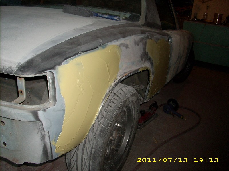

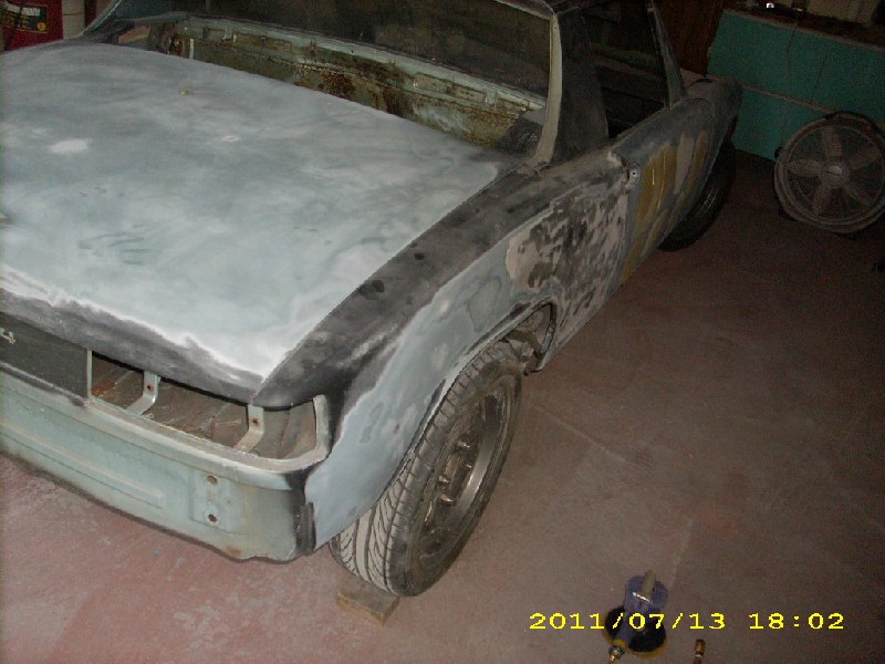

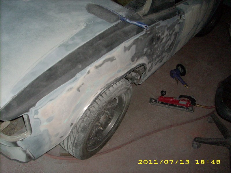

Got an hour in.
Bunch of time sanding out what was in there. Took it down to metal on most places and then to the existing bondo everywhere else just because this fender has been worked on so much. The existing bondo looked really good in most area's.
Threw some bondo on it as well. About 1/8 of a gal. This will probably take another 1/4 gal of bondo before its done. This filler is pretty thin so I can only really put it on 1/4" at a time which I really dont mind all that much.
Spent the rest of the night on my car, trying to swap carbs, but the other carb leaked like crazy... So swapped it back... yay, non progress....
