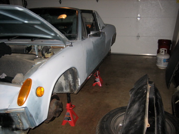

Well, I thought this would never happen, but she went up on the stands tonight.
-this may be a slower progress thread as I work and have practice till 8pm everday except friday. But, it will get done!!!!
Here are some pictures for now.

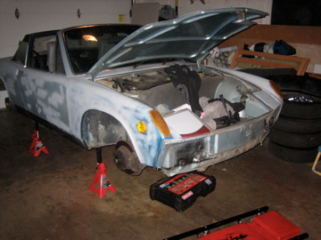

So, updates for the weekend
-the engine is out!!!! my brother and my two friends came over to help with the removal. all went well. got a little hung up on some of the engine tin, but easily fixed with a little massaging of the tin.
-removed the rest of the floor tar, so now the entire floor and backpad is ready to be sanded/grinded down to bare metal then I will por-15 the entire inside.
here are some pics...
