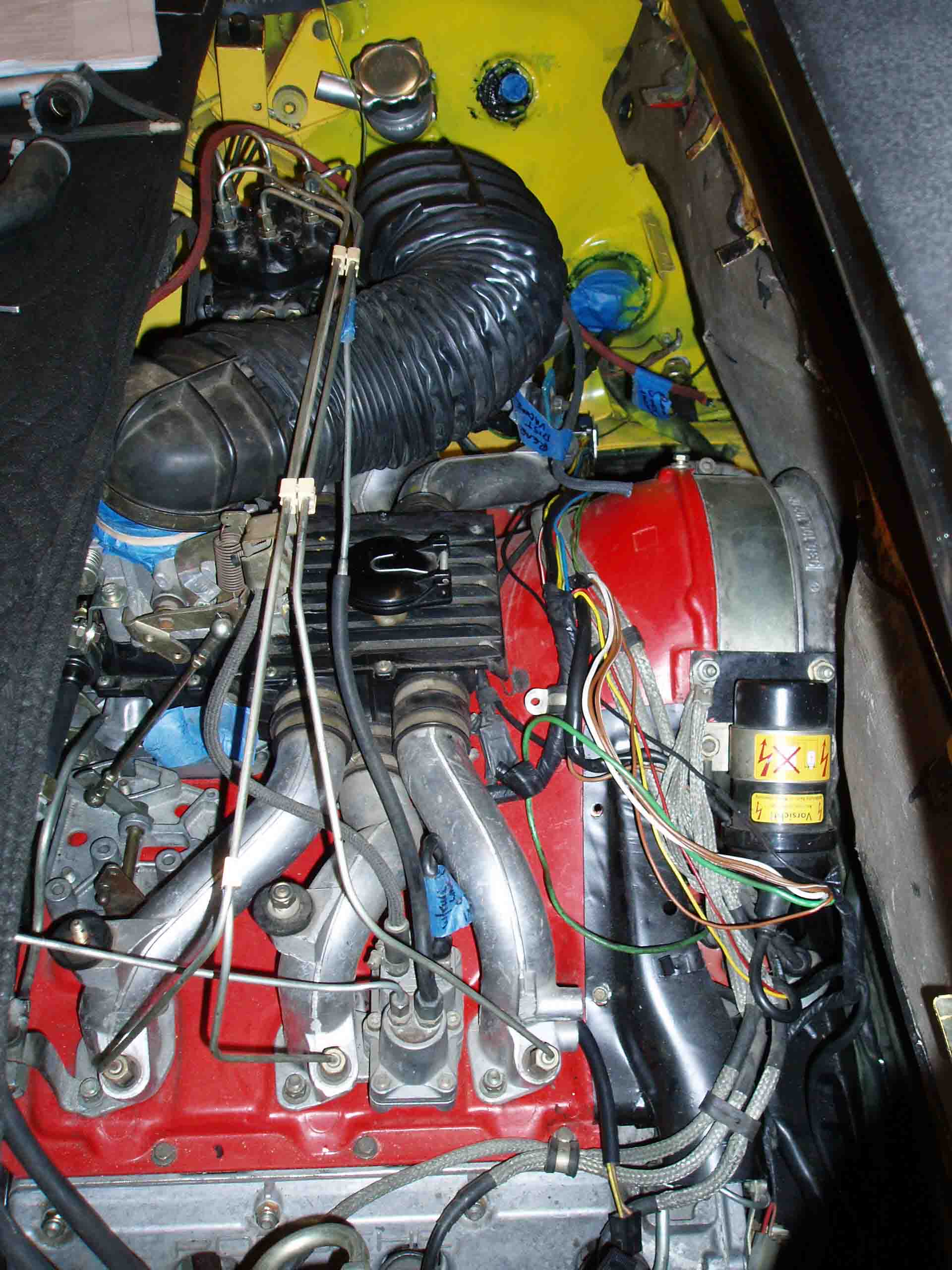

Jeffs9146   Here are a few photos   Jul 17 2011, 08:25 AM
SirAndy   Here are a few photos You should post a picture o...   Jul 17 2011, 12:03 PM

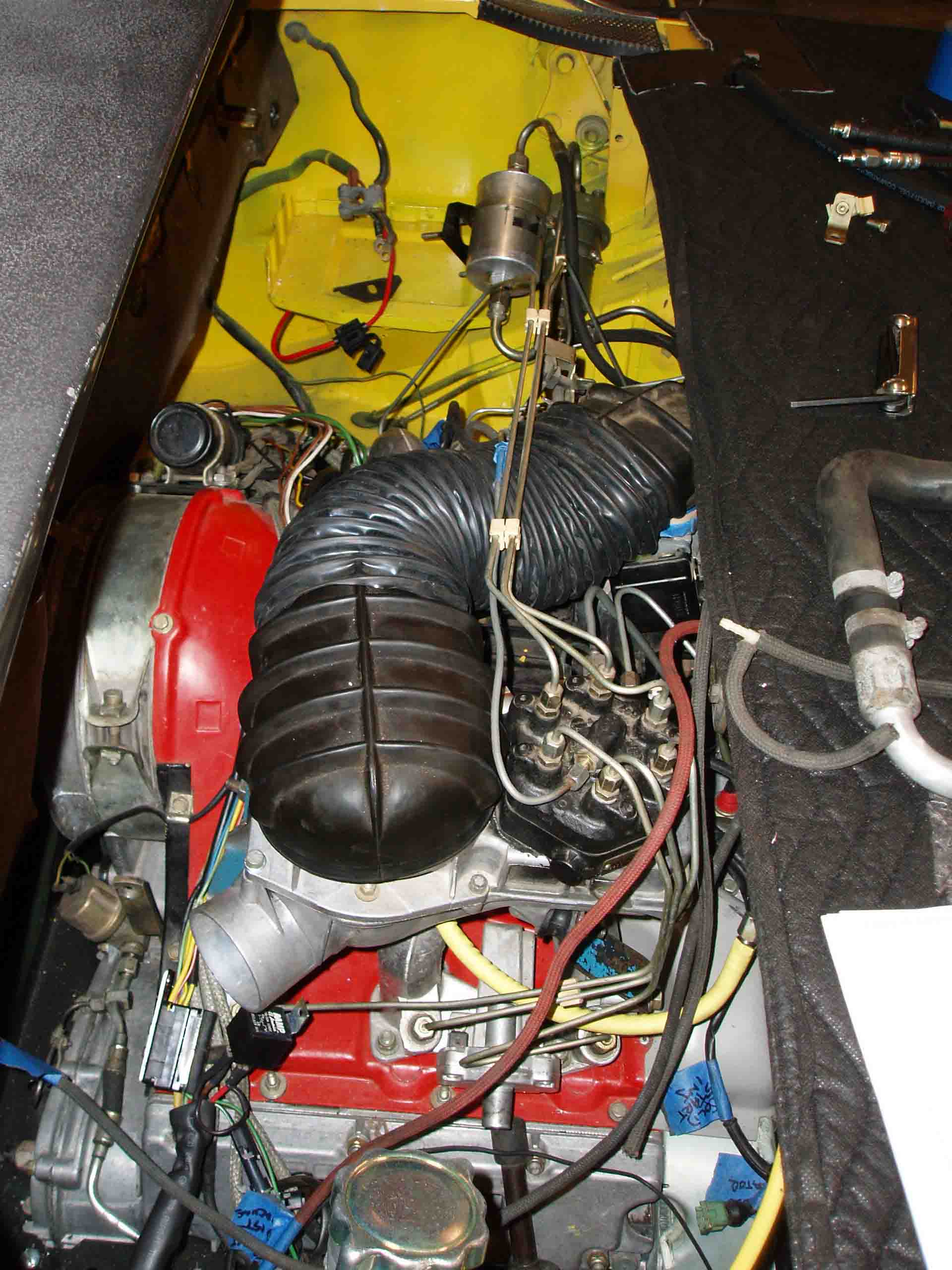

Jeffs9146   Ok here is our custom intake "snorkel"   Jul 17 2011, 12:27 PM

Andyrew   Painters tape holding the snorkle to the TB.. LOVE...   Jul 17 2011, 03:19 PM
Jeffs9146   Andy wanted a photo of the snorkle so I placed i...   Jul 17 2011, 08:24 PM
