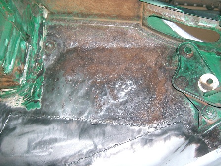

Took a wire wheel to the inner wheelhouse section to prep for primer...discovered a lot of surface rust in ths area that will require treatment before primer.

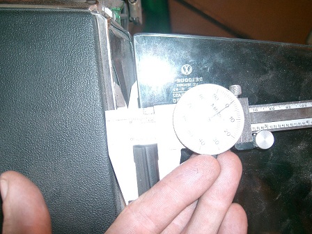

After reading other build threads on here, I have been pretty vigilant about keeping an eye on the door gaps and taking my time welding to keep the heat down. I have made a couple of small tweaks along the way, but the gaps have held well. Checking gaps after welding in the upper wheelhouse section, there was a more noticeable difference. After some adjustments to the turnbuckle, I was able to able to get it within .030" of the drivers side and still have the door close OK. The door now requires more effort to close it and will need some final tweaking.
