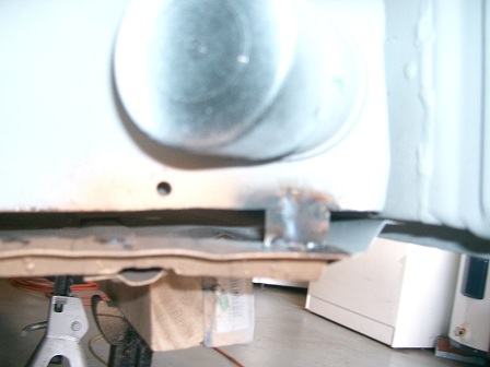

Finally got my new inner long welded in with doubler plates on all seams. Verified the incline of the new long with an incline gauge (with the car level) following Jeff Hails build thread. Door operates well! Entire inner long has been coated with rust encapsulator.
Still have a long way to go but I am hoping that this was the toughest part.

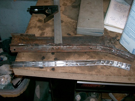

saigon71   While waiting on the inner "ply" for the...   May 15 2011, 06:32 PM
saigon71   Cutting - continued: Luckily, it looks like the ...   May 15 2011, 06:42 PM

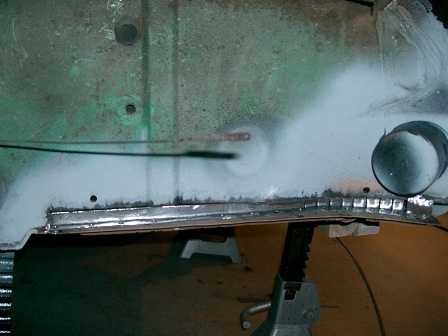

saigon71   Progress continues at a slow, but steady pace. Co...   Jun 12 2011, 09:15 AM
saigon71   Put the tank back together with a new Foley fuel s...   Jun 12 2011, 09:26 AM
saigon71   I wasn't in the mood to spray primer yesterday...   Jun 12 2011, 09:34 AM
