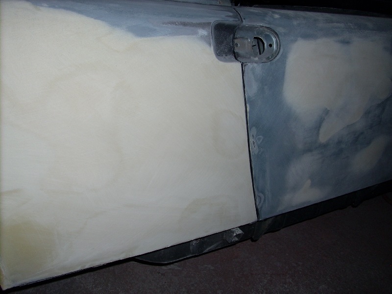

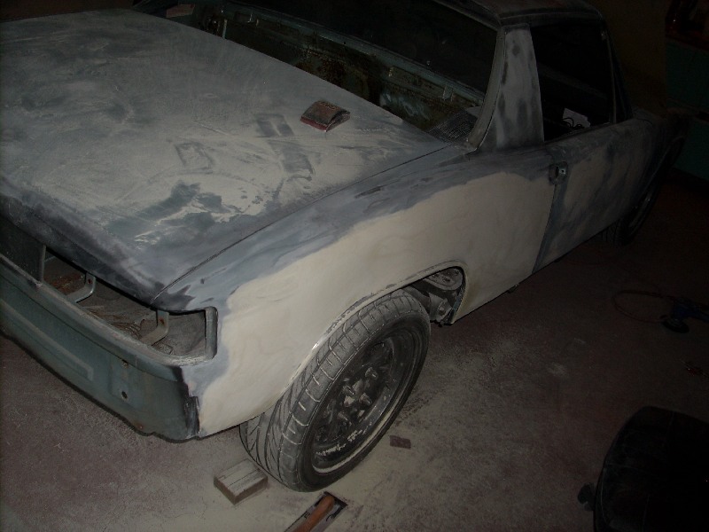

Got to 75% done on the rear fender. Really dont have much time left on it and its looking really good. I have to go over it with 180 grit but it almost completely roughed in.

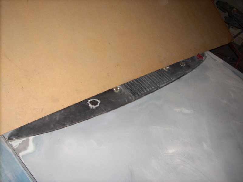

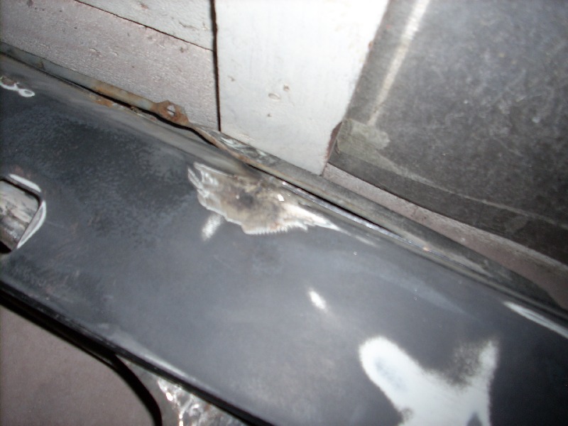

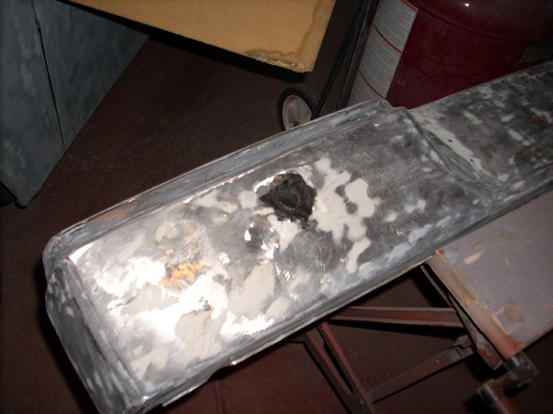

I also welded the holes for the window washers. I welded the rocker pannel crack and the rear valence crack. I straightened the rear valance (It will need some bondo...), and put a skim coat on the rear bumper.
