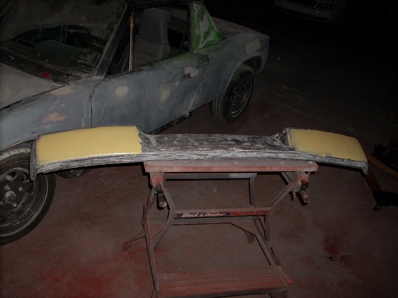

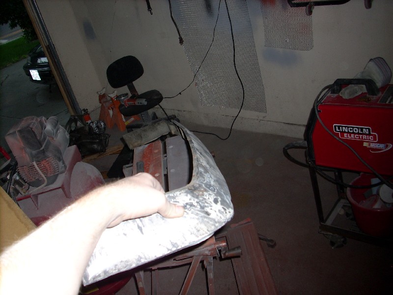

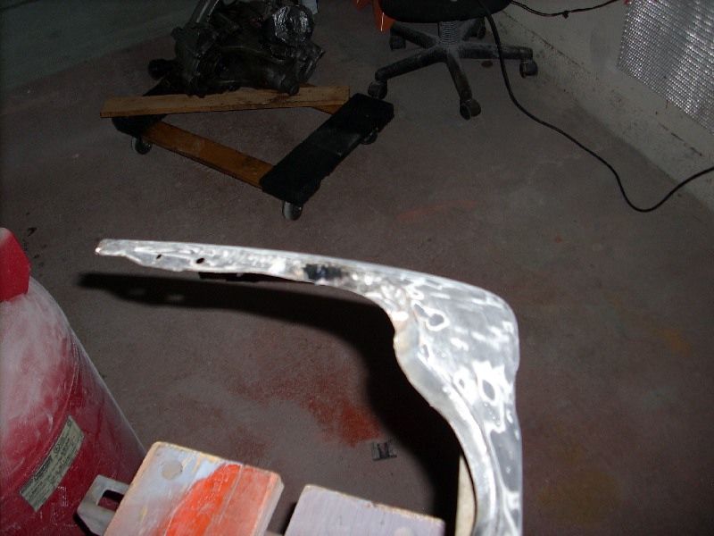

Andyrew   This work was from Saturday. Peter came over, we...   Jul 11 2011, 09:18 AM
Andyrew   Next   Jul 11 2011, 09:19 AM
Andyrew   Last. I started working on filling the bumper, bu...   Jul 11 2011, 09:21 AM
RiqueMar   Looks good guys! Your making really good time...   Jul 11 2011, 09:33 AM

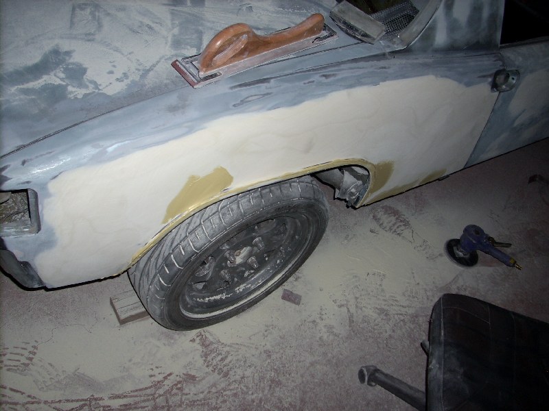

Andyrew   Spend another hour and a half tonight. Sanded do...   Jul 12 2011, 09:24 PM

Andyrew   Got an hour in. Bunch of time sanding out what w...   Jul 13 2011, 11:49 PM
