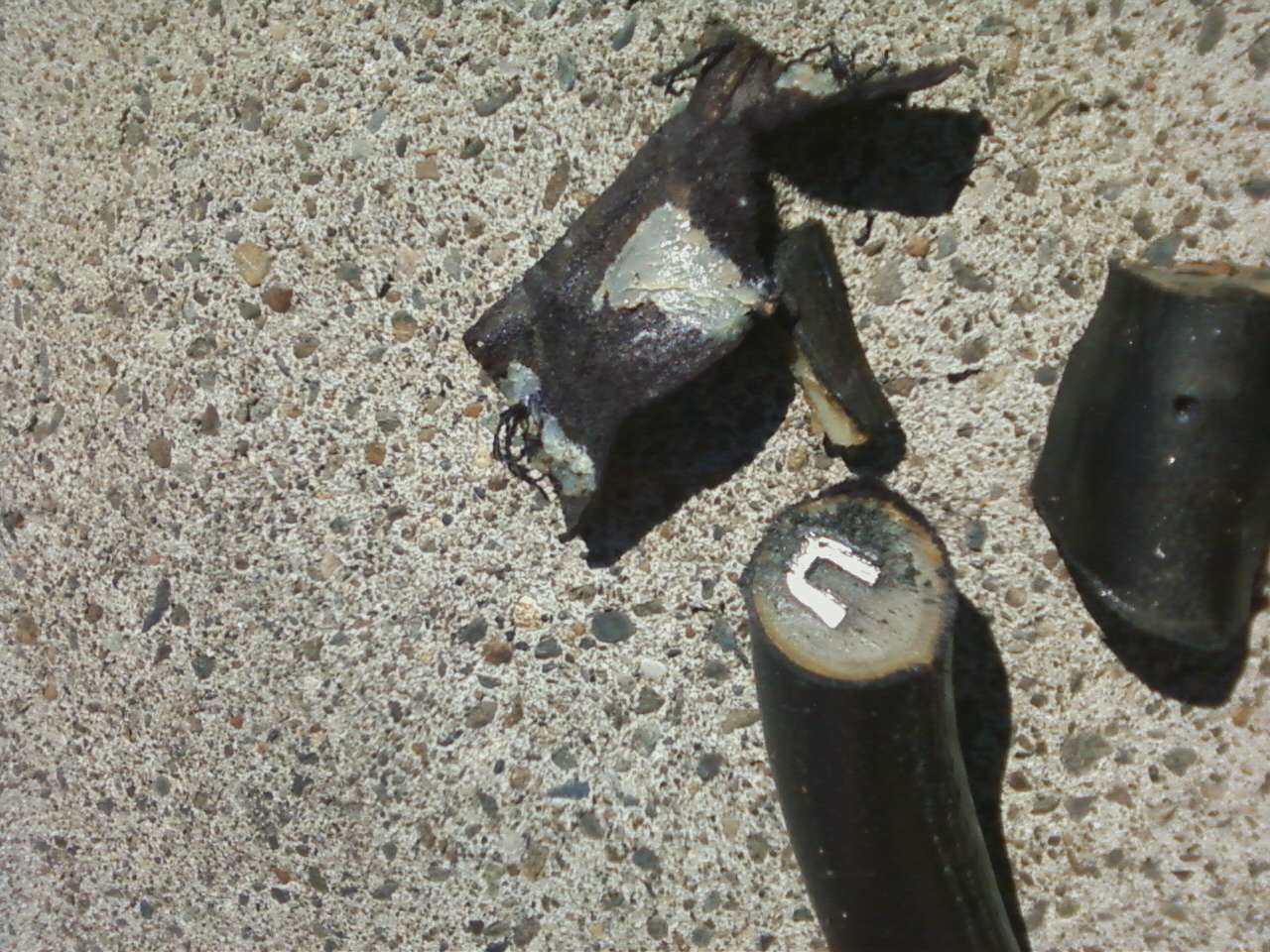

I have an Racemark steeering wheel , the leather is shot and seems to be bubbling something from inside out.
So I attaked it with a band saw. Strange inards, U shaped steel channel ,rivetted to the spokes and then coated with a rubber like goo. Attached thumbnail(s) |

I like my 370mm prottipo in my GT, so I decied to make my Racemark 370mm
Rolled a piece of 6061 al 1.05 dia. to 370mm and welded it to the spokes. Attached thumbnail(s) |

racerbvd Whoa!!! :sawzall:
So you rebuilt you... Jul 23 2011, 12:10 PM
sixnotfour I searched everyware for Corinthian leather, No lu... Jul 23 2011, 12:14 PM

racerbvd So that is one big steel ring??? You will want to ... Jul 23 2011, 12:19 PM
sixnotfour Its an aluminum tube . It is way lighter than the ... Jul 23 2011, 12:23 PM
racerbvd Be carefull, you may start getting hit up with req... Jul 23 2011, 12:50 PM

rick 918-S How did you attach the aluminum tube to the steel ... Apr 16 2012, 06:24 PM
gothspeed ^^ I think the center tri-spoke was aluminum too, ... Apr 16 2012, 06:59 PM![]() ![]() |
