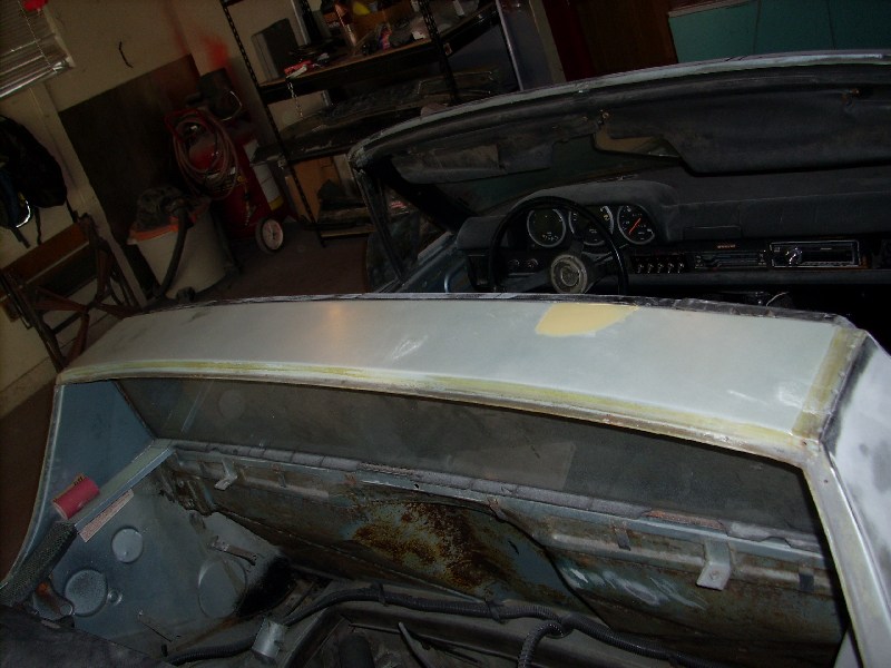

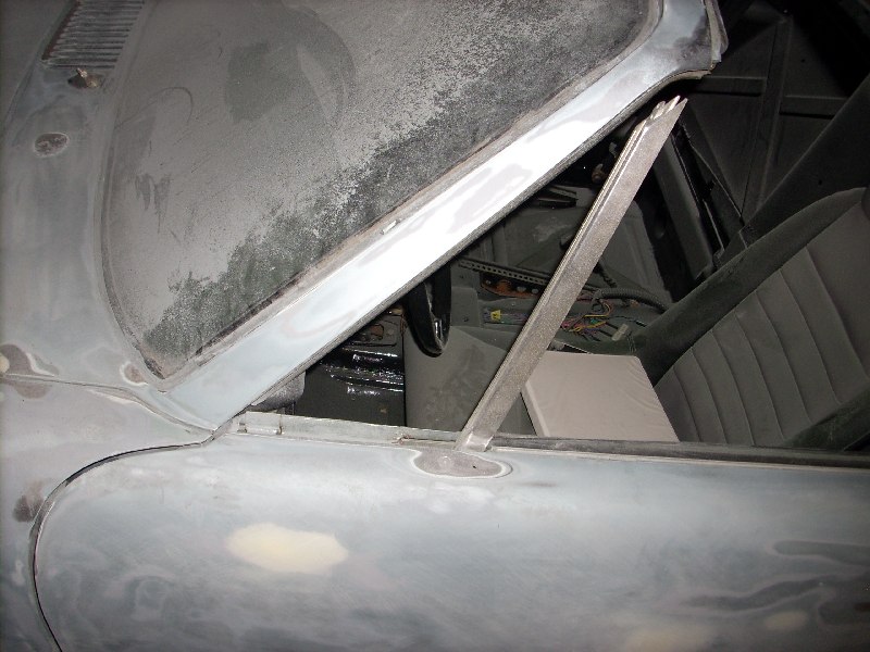

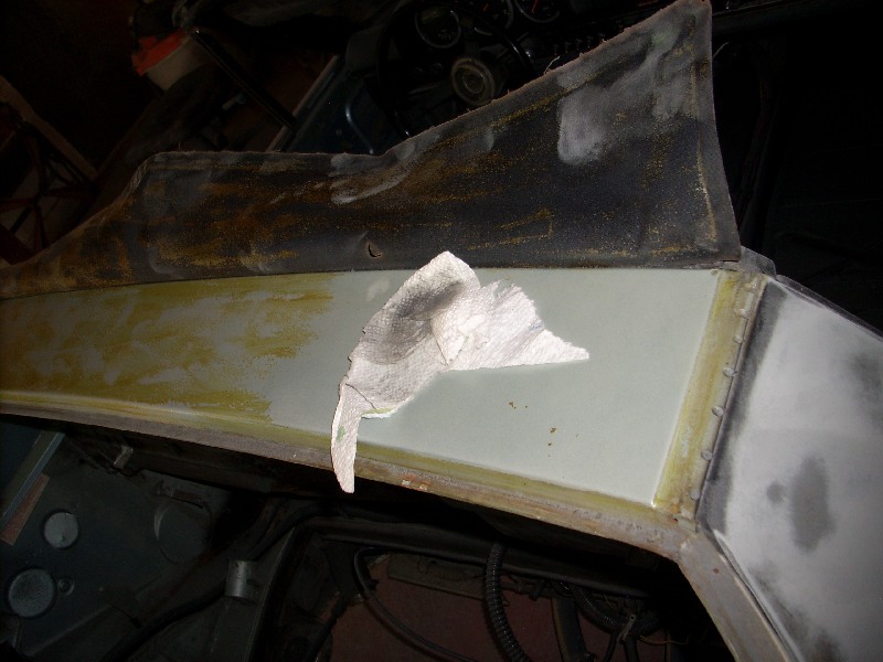

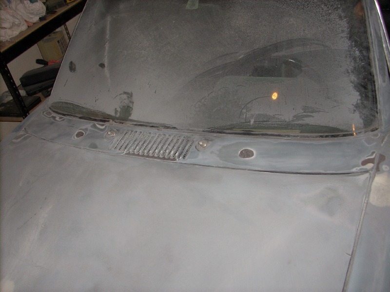

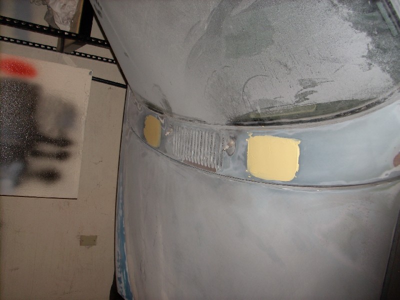

Had a lot of erands to run yesterday but I still got most of the progress I wanted to accomplish before today.
Got 2 hours in.
Pulled the vynal off the targa bar, used acetone to clean the glue off, filled a little dent, and sanded it down with 180 grit.
Sanded the cowl area down, Filled the dents where the washers were and sanded it down with 180.
Finished the fender area as well as most of the molding of the fender lip. I still have the front of the fender to go and that might be a little bit difficult.. But that will be finished today.
I still need to put some glazing puddy down to fill some pinholes and sand the fender down to 180 and then the whole car is ready for primer filler.
