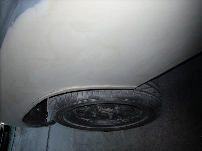

Andyrew   Aaaand progress from today :) Got an hour and a ...   Jul 11 2011, 11:14 PM
Andyrew   Last pic shows the fender rolled.   Jul 11 2011, 11:16 PM

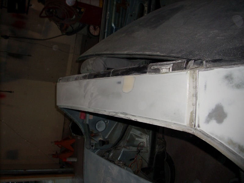

Andyrew   Had a lot of erands to run yesterday but I still g...   Jul 24 2011, 09:49 AM
Andyrew   Next   Jul 24 2011, 09:51 AM
Andyrew   Last Also sanded the A pillar.   Jul 24 2011, 09:51 AM

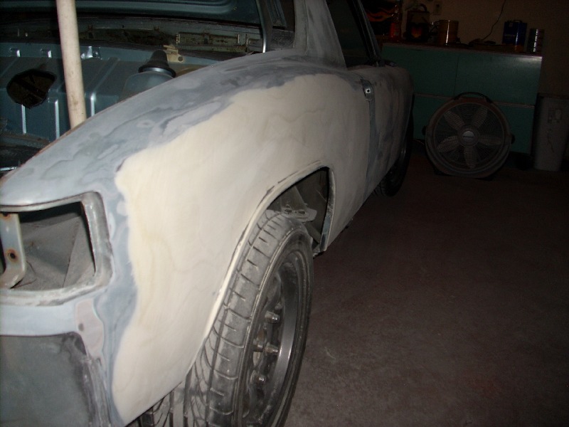

Andyrew   Spent a little over 2 hours block sanding yesterda...   Jul 28 2011, 08:20 AM
malaga_red75   awesome andrew! and you're right, the p...   Jul 28 2011, 09:51 AM

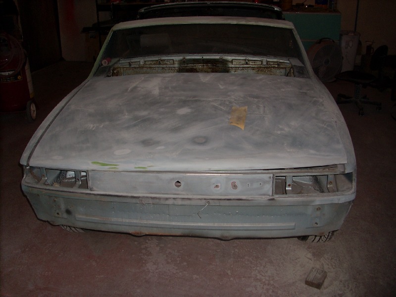

Andyrew   No pics again from this past weekend (Who wants to...   Aug 1 2011, 02:47 PM

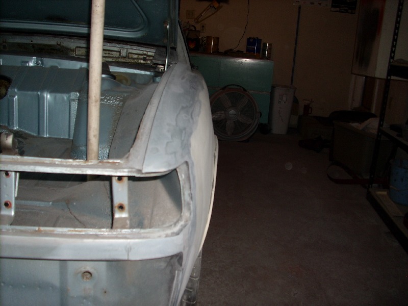

Andyrew   So I sanded down the primer filler and there are s...   Aug 1 2011, 11:14 PM
malaga_red75   So I sanded down the primer filler and there are ...   Aug 1 2011, 11:45 PM
Andyrew   I decided that I'll sand down the low spots a ...   Aug 1 2011, 11:44 PM
