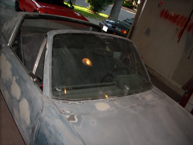

Andyrew   This was the progress made on Sunday, I didnt do a...   Jul 19 2011, 09:17 AM
Andyrew   Yes I used 1/2 a gallon of filler. That fender nee...   Jul 19 2011, 09:21 AM

Andyrew   Had a lot of erands to run yesterday but I still g...   Jul 24 2011, 09:49 AM
Andyrew   Next   Jul 24 2011, 09:51 AM
Andyrew   Last Also sanded the A pillar.   Jul 24 2011, 09:51 AM
