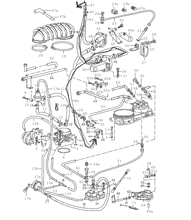

I am very close to starting and would like to get a confermation about the AAR and Cold Start Injector!
Are the only two pieces that I need the ones shown in this photo or do I also need #39??

Jeffs9146   I am very close to starting and would like to get ...   Jul 28 2011, 09:25 AM
jcd914   I am very close to starting and would like to get...   Jul 28 2011, 10:00 AM
