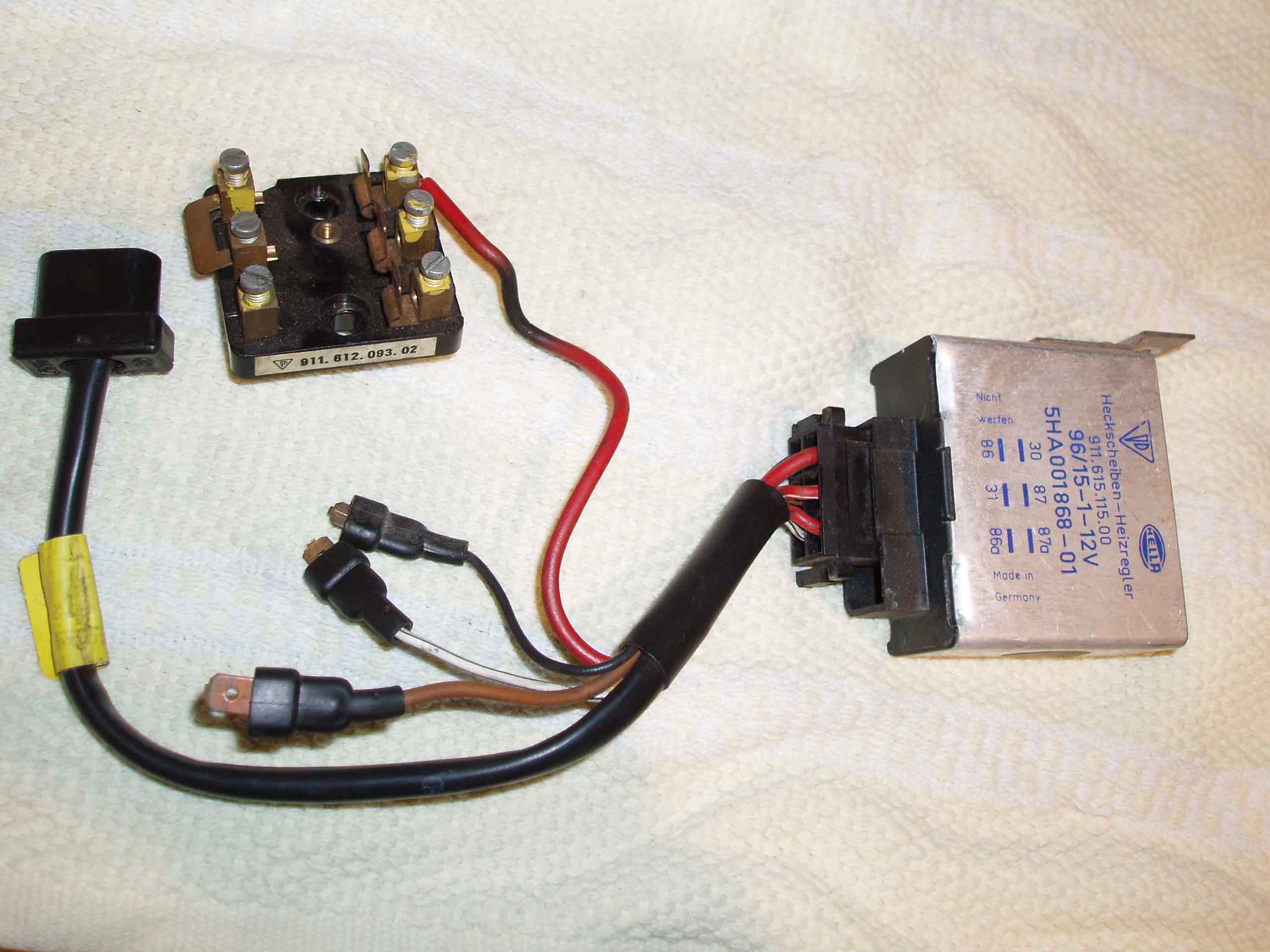

Jeffs9146   It looks like the problem is in this connection fr...   Aug 1 2011, 10:46 PM
kg6dxn   Looks like the red wire should go to the battery +...   Aug 1 2011, 11:00 PM
Jeffs9146   ok I will check the bl/v and the R+ tomorrow! ...   Aug 1 2011, 11:11 PM
kg6dxn   ok I will check the bl/v and the R+ tomorrow...   Aug 1 2011, 11:20 PM
kg6dxn   Follow the "V5" connection on the 911 wi...   Aug 1 2011, 11:23 PM

Jeffs9146   OK I traced down the BL/Vi wire and it goes to the...   Aug 2 2011, 09:27 AM
Jeffs9146   Bump for more info :beer2:   Aug 2 2011, 12:54 PM
Jeffs9146   I spent most of the day looking at the full sized ...   Aug 2 2011, 05:07 PM
kg6dxn   I spent most of the day looking at the full sized...   Aug 2 2011, 05:49 PM
Jeffs9146   OK so what you are saying is the Blue wire that ...   Aug 2 2011, 06:03 PM
kg6dxn   OK so what you are saying is the Blue wire that...   Aug 2 2011, 06:14 PM
Jeffs9146   Right! So Blue on 914 is not good for Black/Vi...   Aug 2 2011, 06:39 PM
kg6dxn   Jeff got it running! :Qarl: He found an extra ...   Aug 2 2011, 09:10 PM

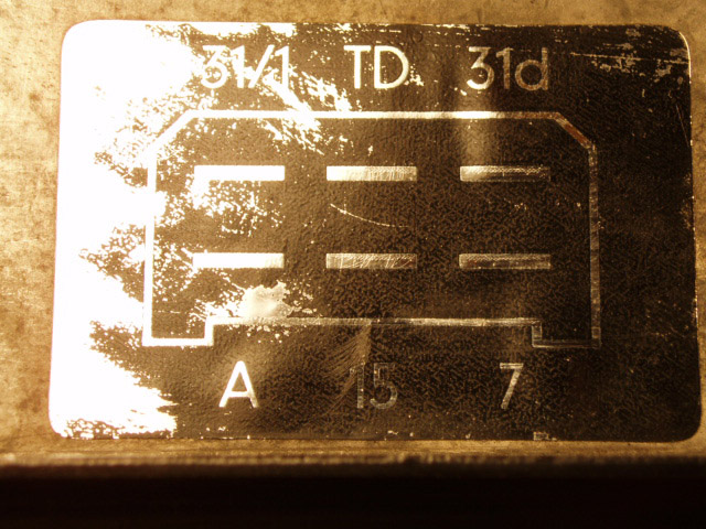

Jeffs9146   OK new issue! I tried to install the 3.0L tach...   Aug 9 2011, 07:08 PM
Dr Evil   It looks like TD is your Tach out. Where is your B...   Aug 9 2011, 07:44 PM
Jeffs9146   It goes to the center pin of the CD box and then h...   Aug 9 2011, 07:55 PM
Jeffs9146   I just tested it to ground from the tach to the bo...   Aug 9 2011, 08:19 PM
Cairo94507   Jeff, If you decide to pull the engine back out th...   Aug 9 2011, 09:07 PM
Jeffs9146   I will let you know when it is comming out! :b...   Aug 9 2011, 09:15 PM
kg6dxn   Your tach will need to connect to the - side of th...   Aug 9 2011, 10:26 PM
Jeffs9146   Ok so if I take the blk/purple away from the CD un...   Aug 9 2011, 10:49 PM
kg6dxn   Ok so if I take the blk/purple away from the CD u...   Aug 9 2011, 10:51 PM
kg6dxn   Ok so if I take the blk/purple away from the CD ...   Aug 9 2011, 10:52 PM
