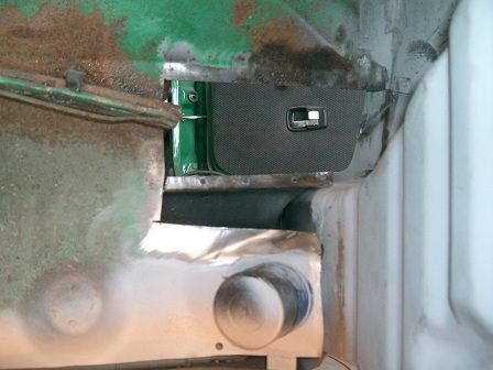

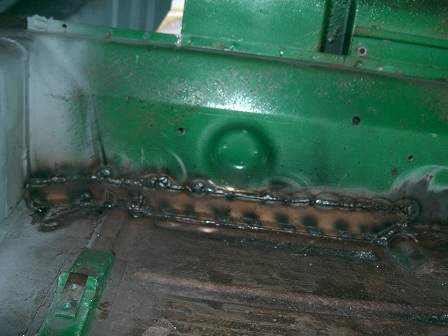

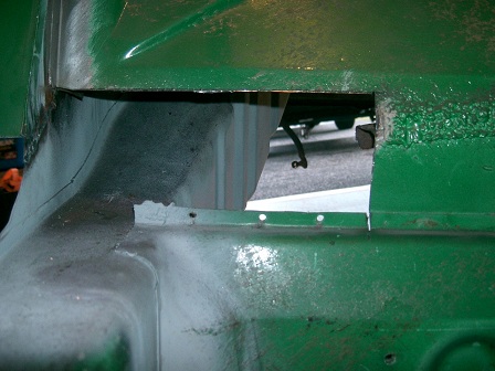

Finally got my new inner long welded in with doubler plates on all seams. Verified the incline of the new long with an incline gauge (with the car level) following Jeff Hails build thread. Door operates well! Entire inner long has been coated with rust encapsulator.
Still have a long way to go but I am hoping that this was the toughest part.
Thanks to Scotty B, Jeff Hail, and everyone else who has posted a build thread on this topic. I have read all of them & learned a lot. (IMG:style_emoticons/default/beerchug.gif)

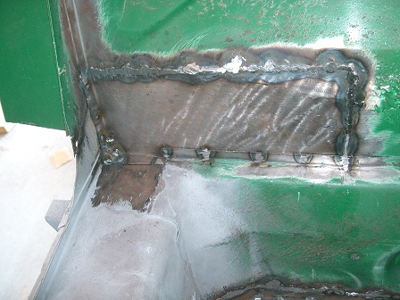

Welded in the lower inner vertical firewall piece:

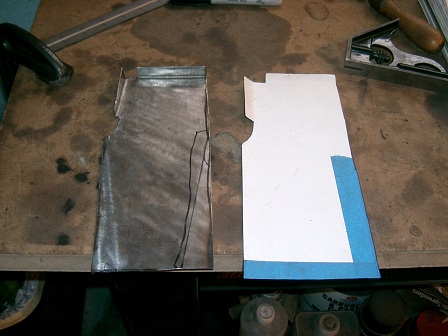

I had a large rusted section above the long on the firewall that had to be farbricated and replaced. Went with a posterboard template to get the shape accurate:

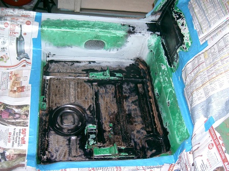

Finally, a solid inner floorpan on the passenger side! (IMG:style_emoticons/default/beerchug.gif) I decided to prep this 1/4 of the pan for finish...one coat of rust converter applied:
