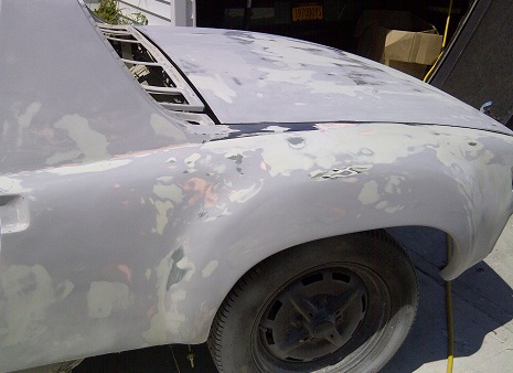

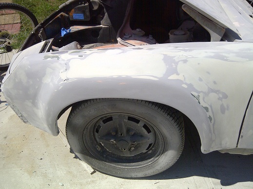

I got a lot done today. I spent 4 hours guide coating and sanded the entire car less the hood.

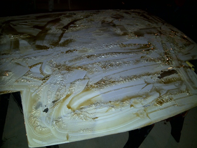

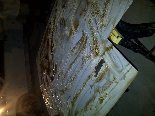

as I mentioned , the hood needs a complete do over due to bubles on the previous primer (previous PO) perhaps was sitting for too long. I used th wonderfull airplane paint remover to get it stripped.

ppetion   I got a lot done today. I spent 4 hours guide c...   Aug 2 2011, 11:05 PM
Spoke   Good deal on the hood. Laying down paint on a unst...   Aug 3 2011, 02:56 AM
ppetion   Good deal on the hood. Laying down paint on a uns...   Aug 3 2011, 09:41 AM
Andyrew   Make sure you neutralize that aircraft sripper bef...   Aug 3 2011, 08:21 AM
