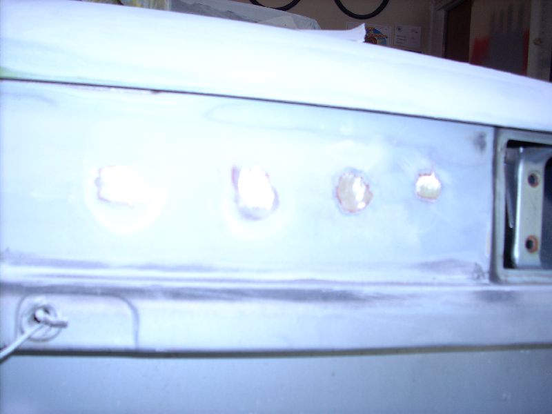

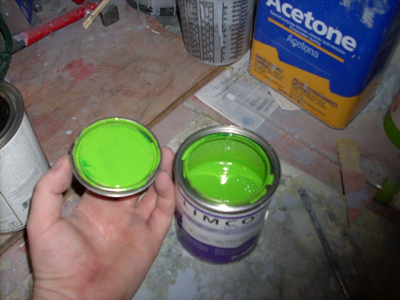

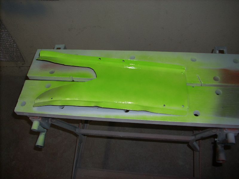

Laid the test color. Its hard to tell if its the right color. I really need to get it in the sun to see what happens.
Oh and im going to unload all the pics from my camera that I have been taking (IMG:style_emoticons/default/smile.gif)

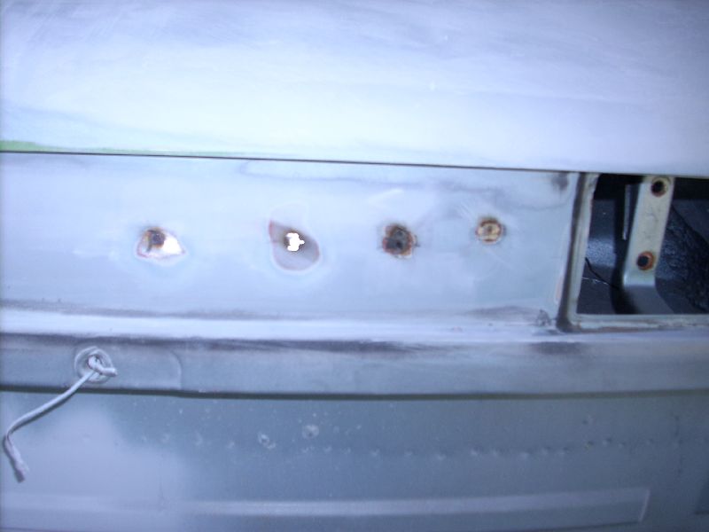

Andyrew   A LOT more nicks than I thought there would b...   Jul 2 2011, 10:56 PM

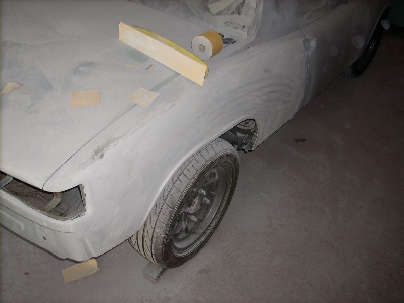

Andyrew   Spend another hour and a half tonight. Sanded do...   Jul 12 2011, 09:24 PM

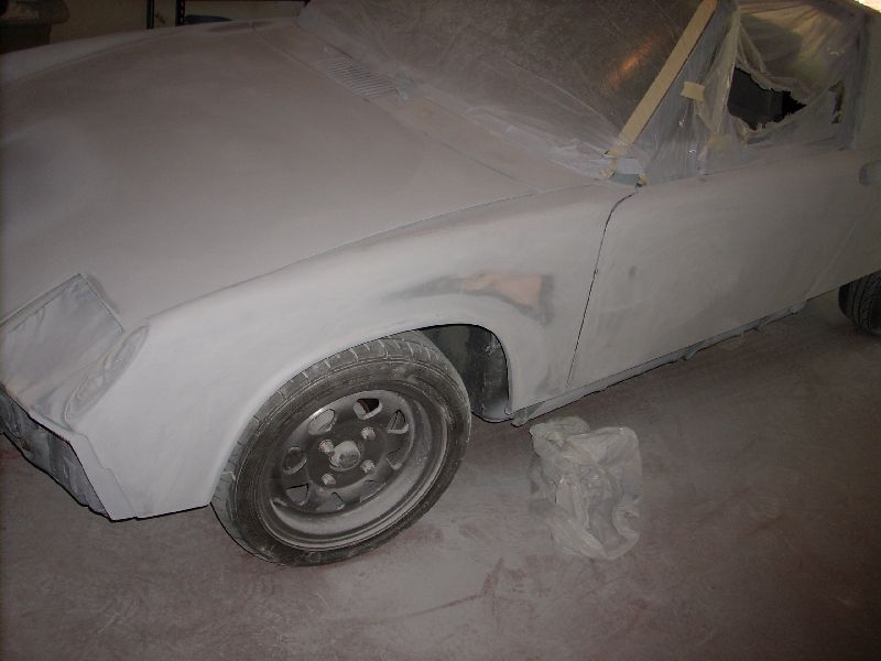

Andyrew   Spent a little over 2 hours block sanding yesterda...   Jul 28 2011, 08:20 AM
malaga_red75   awesome andrew! and you're right, the p...   Jul 28 2011, 09:51 AM

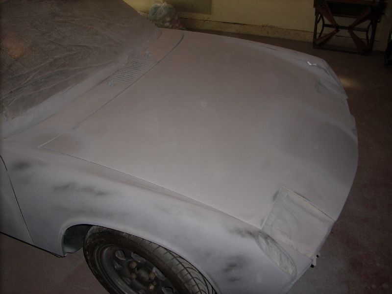

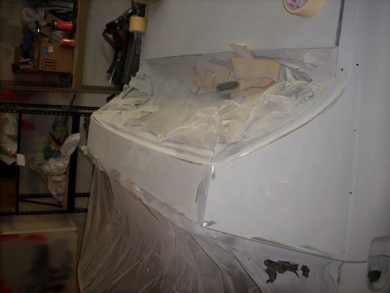

Andyrew   So I sanded down the primer filler and there are s...   Aug 1 2011, 11:14 PM
malaga_red75   So I sanded down the primer filler and there are ...   Aug 1 2011, 11:45 PM
Andyrew   I decided that I'll sand down the low spots a ...   Aug 1 2011, 11:44 PM

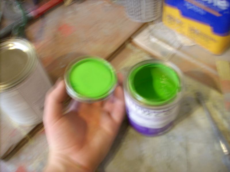

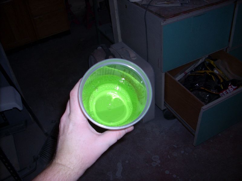

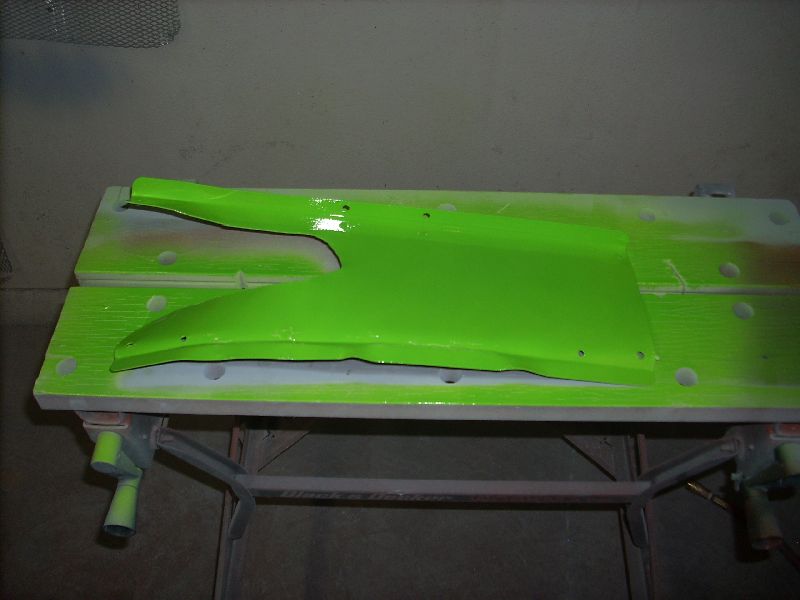

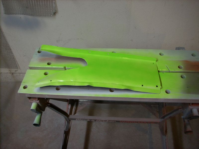

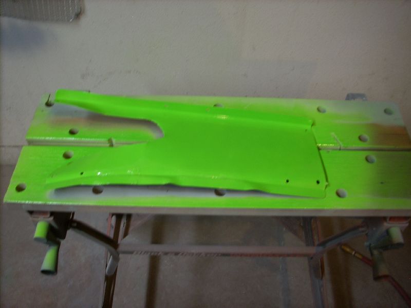

Andyrew   Laid the test color. Its hard to tell if its the r...   Aug 2 2011, 11:06 PM
Spoke   I like the color.   Aug 3 2011, 02:50 AM
porsche_dreamer   Don't know if its me or the flash on your came...   Aug 3 2011, 07:50 AM
Andyrew   It is a tad to yellow. We cant find the correct mi...   Aug 3 2011, 08:17 AM
kg6dxn   I dig the bright breen!   Aug 3 2011, 08:18 AM
porsche_dreamer   Ah hell I knew I should of brought it with me home...   Aug 3 2011, 08:29 AM
Andyrew   We have tried calling but no one seems to have the...   Aug 3 2011, 09:22 AM
