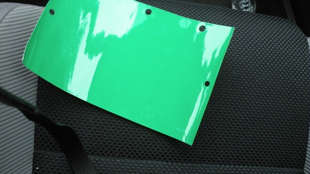

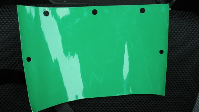

Don't know if its me or the flash on your camera making it look a tad to yellow? Here is a sample I mixed at work and did a spray out with.
(IMG:http://www.914world.com/bbs2/uploads_offsite/i892.photobucket.com-12505-1312379403.1.jpg)
(IMG:http://www.914world.com/bbs2/uploads_offsite/i892.photobucket.com-12505-1312379404.2.jpg)

Andyrew   Laid the test color. Its hard to tell if its the r...   Aug 2 2011, 11:06 PM

porsche_dreamer   Don't know if its me or the flash on your came...   Aug 3 2011, 07:50 AM
Andyrew   It is a tad to yellow. We cant find the correct mi...   Aug 3 2011, 08:17 AM
kg6dxn   I dig the bright breen!   Aug 3 2011, 08:18 AM
porsche_dreamer   Ah hell I knew I should of brought it with me home...   Aug 3 2011, 08:29 AM
Andyrew   We have tried calling but no one seems to have the...   Aug 3 2011, 09:22 AM
