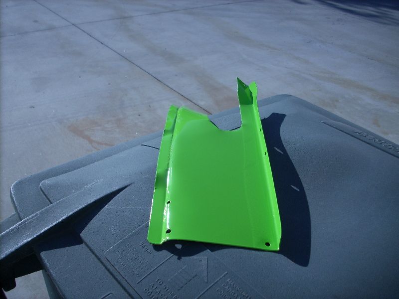

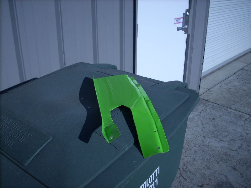

We have tried calling but no one seems to have the ratio..
Yes were setup with Limco.
Heres it in the sun. This bluish effect is just my camera, the color is more green than the pic shows.
