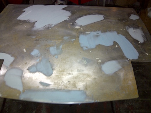

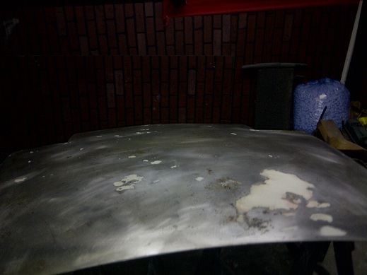

Well, I did not do what I had planned for the evening, but it was not wasted. I wanted to do what i call a posible final prime, but the rain didn't do me justice. it has been raining all evening here.
I managed to finish stripping the hood, treat it with brake cleaner to get the chemical out and repatch the needed spots with bondo. it is all ready for primer.

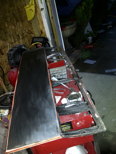

I also sanded the engine cover and have it ready for primer as well. we will see what the weater brings tomorow.

Andyrew   Brake cleaner should work but personally I wouldn...   Aug 3 2011, 11:23 PM
ppetion   Brake cleaner should work but personally I wouldn...   Aug 4 2011, 09:04 PM
