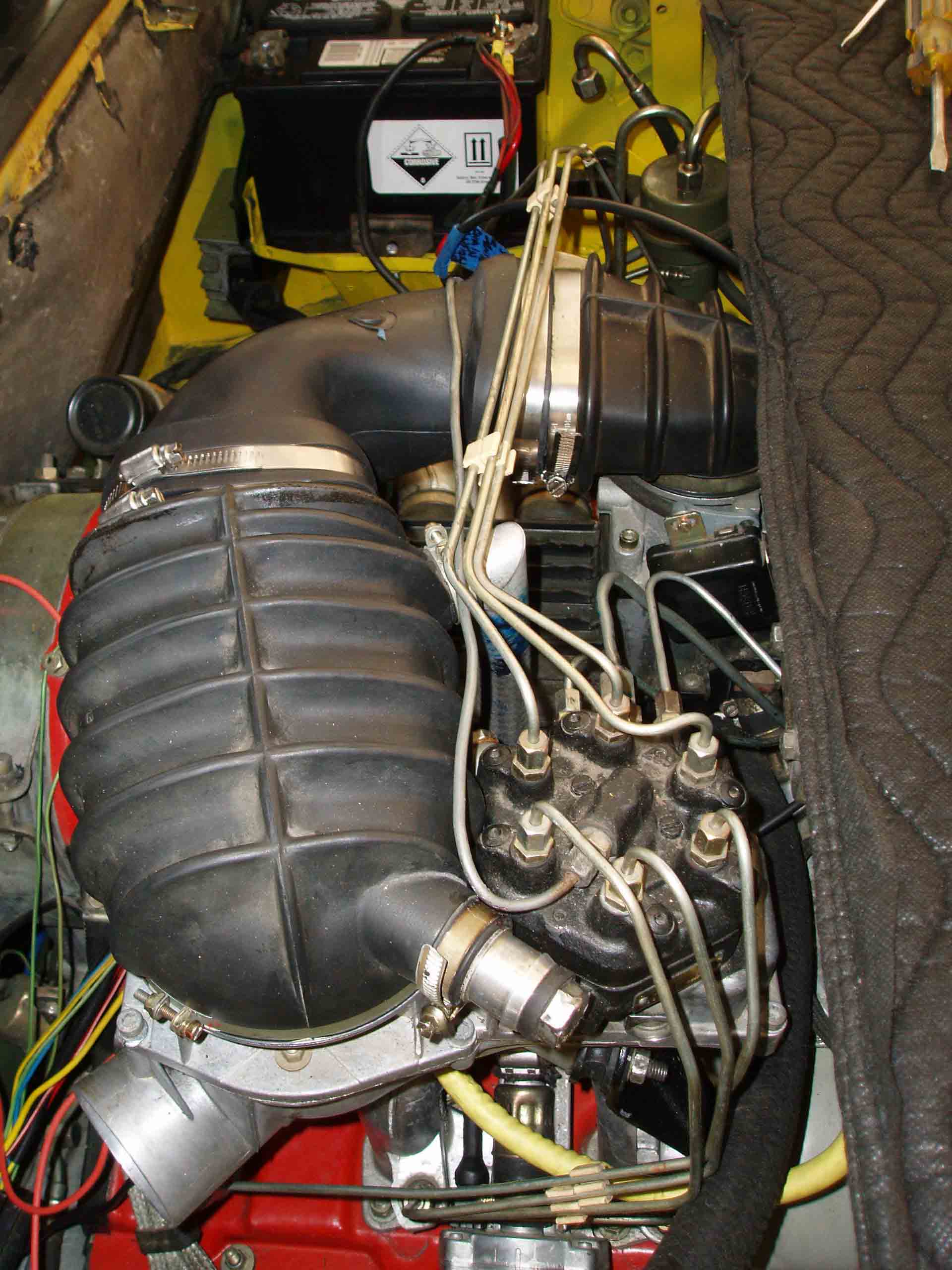

Jeffs9146   Ok here is our custom intake "snorkel"   Jul 17 2011, 12:27 PM

Andyrew   Painters tape holding the snorkle to the TB.. LOVE...   Jul 17 2011, 03:19 PM
Jeffs9146   Andy wanted a photo of the snorkle so I placed i...   Jul 17 2011, 08:24 PM

Jeffs9146   I am very close to starting and would like to get ...   Jul 28 2011, 09:25 AM
jcd914   I am very close to starting and would like to get...   Jul 28 2011, 10:00 AM
Jeffs9146   Thanks Jim! I redid the "Snorkle" a...   Jul 28 2011, 10:16 AM
