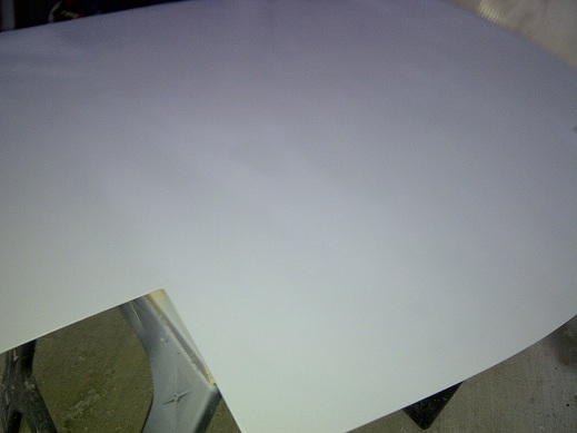

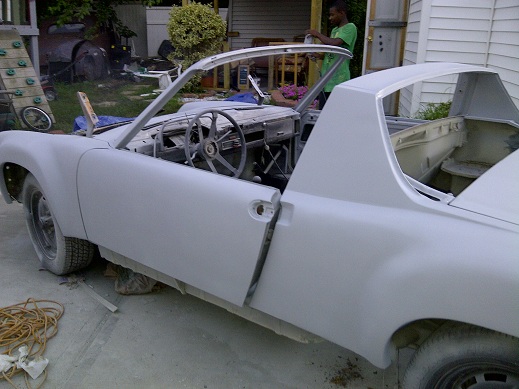

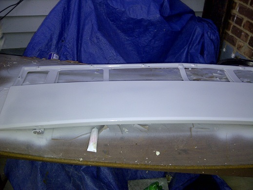

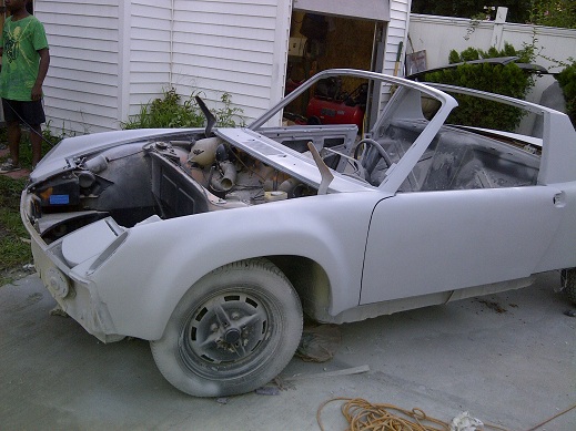

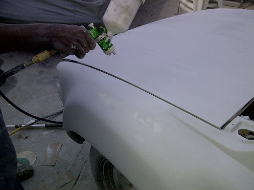

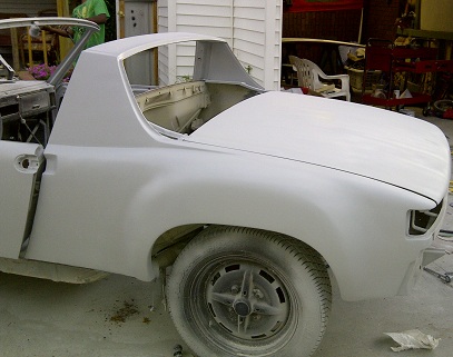

I spent about 2 hours doing more pain striping on the panel below the winshield, that was the final part with that old primer. Better to be safe than sorry. then came the fun part.
The car is fully primed, I have about 10 small spots to go over, and it is ready for paint. the small parts should take me about an hour, includes reprime over the sopts.
I just got a tracking number for my paint, it looks like i should have it by thursday. I think that i will be painting saturday if the weater is ok.. here are the pics enjoy!
