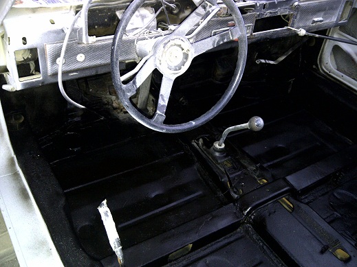

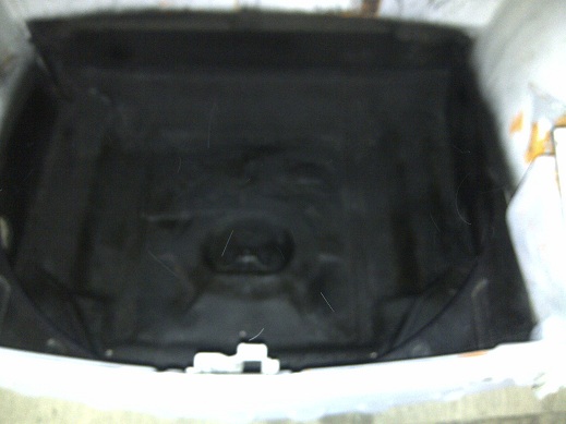

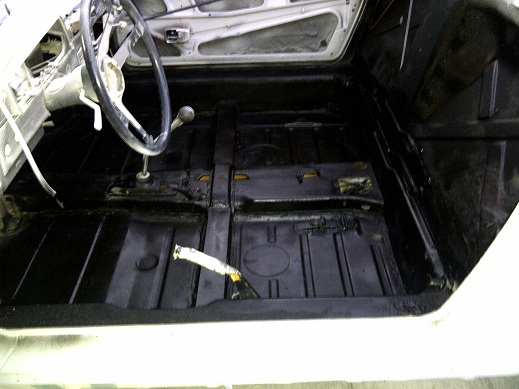

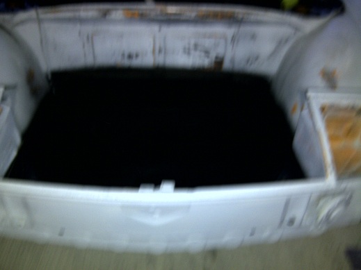

I put on another 3 Hours yesterday sanding the front hood and engine bay cover. I also went over the car for pin holes and imperfections.
I preped the trunks and floors using paintable rubberized spray. and cleaned the whole car. getting ready for paint over the weekend.
