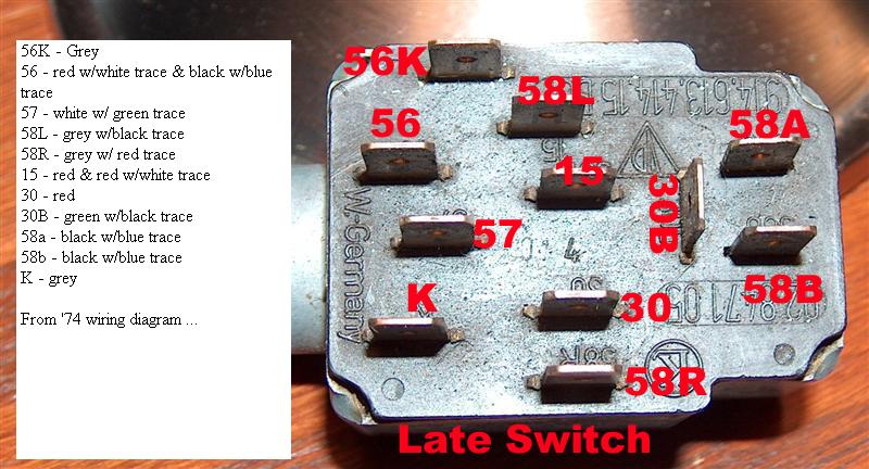

Can any one tell me what color wires go where?

Got a follow up question to the headlight switch wiring: Which terminal/&lights are activated when the knob is pulled out at the first stop, then the second stop ?

SLITS   56K - Grey 56 - red w/white trace & black w/b...   Aug 9 2011, 05:22 PM
raw1298   56K - Grey 56 - red w/white trace & black w/...   Aug 9 2011, 05:26 PM

SLITS   Well Jimmy ... ya gotta think about it ... What c...   Aug 10 2011, 01:36 PM
jim_hoyland   Thanks Ron, that gets me started in the direction ...   Aug 10 2011, 02:39 PM

jim_hoyland   Note: Diagram of the late switch may be in error. ...   Aug 13 2011, 05:25 PM

JeffBowlsby   That switch is not correct for your 914 1.8L. The...   Jun 12 2024, 12:07 PM
