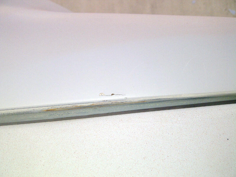

These cracks keeps pooping every now and then I must have patched 5 of them already. now one popped up as I am ready to paint. what can cause that and what can I do?

ppetion   These cracks keeps pooping every now and then I mu...   Aug 12 2011, 02:16 PM
