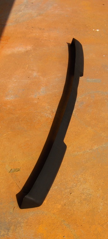

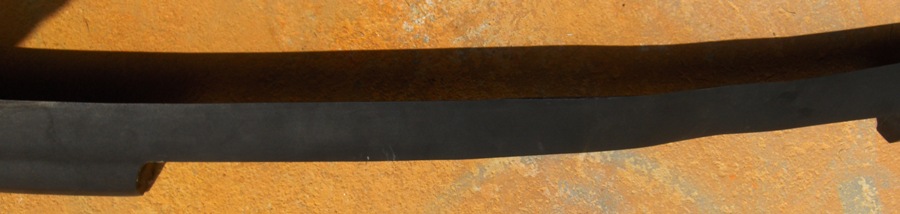

So far everything has done well expect when I took my bumpers apart the front Bumper top had 4-5 dents in the outer edge from bumping into things. I reached out to 914rubber for a new set and had planned on buying. Last night I noticed the bumper itself had a pretty tough dent in it behind where the top mounts. I was able to straighten it out enough to make work and when I brought the top up I thought, Can I straighten this?So I spent an hour working on it until it is not actually very straight. The surface area on it is fine, just was wavy.
Would you guys use it? The car will be a driver. I plan on having it at a few cruise in's and meets but I never show any of my cars. The rear will test my abilites so I do suspect I will have to buy one of those.
Here is a picture of it on the car prior to being removed. Not easy to see but you will notice it is wavy on the edge. And two more as it sits this morning.
Thanks for looking and letting my annoy you guys with questions.

Looks very nice. There must be minimal rust inside. Most are wavy, yours looks much better than average

Ok like the votes so far. This is the rear. I am going to play with it tonight. It has the two spots that are wavy.
As far as rust. It seems very strong internally. I beat on the front one with a sledge to get it back straight.
