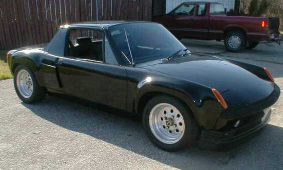

Front air dam holes are small and a long way from fan suction...use them for brake and oil cooling.
I've thought about sail panel scoops, too. (IMG:style_emoticons/default/idea.gif)

69telecaster   Front air dam holes are small and a long way from ...   Aug 19 2011, 07:58 AM
p914   Nice lookin car Telly   Aug 19 2011, 01:55 PM
