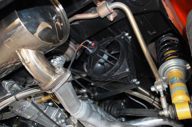

Here is what Joe at 914rs came up with for my six. I originally had an auxillary front oil tank but it took up a lot of room and you had to run the lines through the interior of the car, which would make the car unbearable in the summer. Joe used two small Setrab coolers with a -6 oil tank. It is not an inexpensive conversion, but I believe it is the absolute best way to preserve the engine. You should think about cooling the engine from the inside out not outside in. The damage and wear is caused from the deviation in tempeture to the parts. The lower the operating tempeture, the lower the deviation, the longer the engine will last.

ellisor3   Here is what Joe at 914rs came up with for my six....   Aug 19 2011, 02:07 PM
