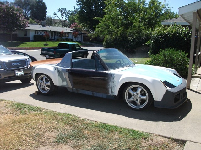

I bought this as a stripped down rolling chassis. The sller put wheels on it to get it on the trailer. That was 4 long years ago. I also had a son at the same time so working on the car has been a second priority. Now the engine is in and the brakes are on, I should be able to get some work done more quickly. I plan on firing this up within the next couple of weeks and taking on a drve by the end of July. I got the 3m adhesive today to get the fenders bonded on and then the fun stuff begins. Hope to get it completed in time for next years West Coast Ramble. Thanks to the support and motivation of the 914World. (IMG:style_emoticons/default/biggrin.gif)

Well it has been awhile so I thought I would give yall an update. First off, scratched cornias suck (IMG:style_emoticons/default/mad.gif) , I was unable to work on the car until mid June. Next time I listen to the doctor (IMG:style_emoticons/default/dry.gif) . Ad a two week family vacation to the northern Oregon coast (IMG:style_emoticons/default/beerchug.gif) and that wraps up most of July. I have recently added a headlight switch and started back up on the body work. Thanks for the advise on using the Rage extreme filler. Works really smooth. I also welded up some brackets for the front bumper and started fitting both bumpers to the car. Here is a new picture to show some of the progress.
