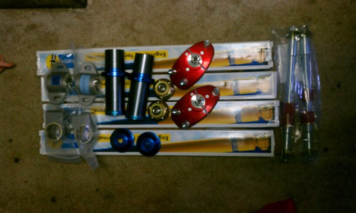

PeeGreen 914   Well this could be interesting :)   Aug 22 2011, 06:15 PM
NORD   Jon What brand are your coilover callers? ...   Aug 22 2011, 07:19 PM
PeeGreen 914   Rebel Racing. I purchased everything from Jonathan...   Aug 22 2011, 08:10 PM
jmill   I bought almost the same stuff with the exception ...   Aug 22 2011, 08:27 PM
PeeGreen 914   Yeah, Jonathan gave me everything :) I would lik...   Aug 22 2011, 08:33 PM
