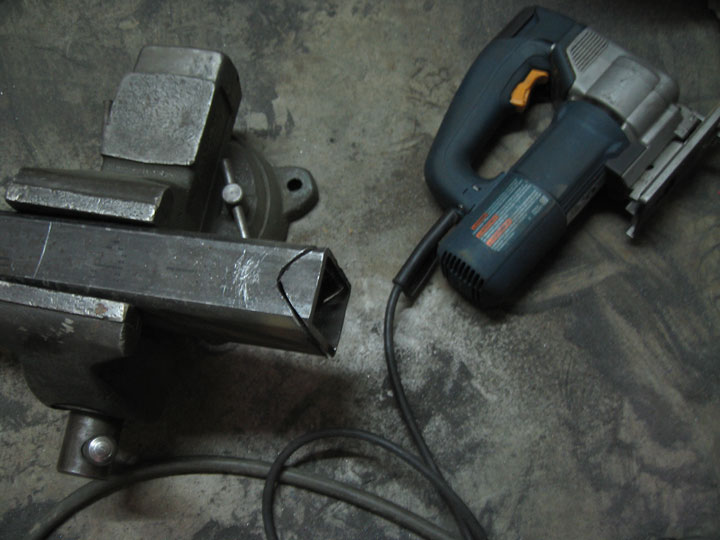

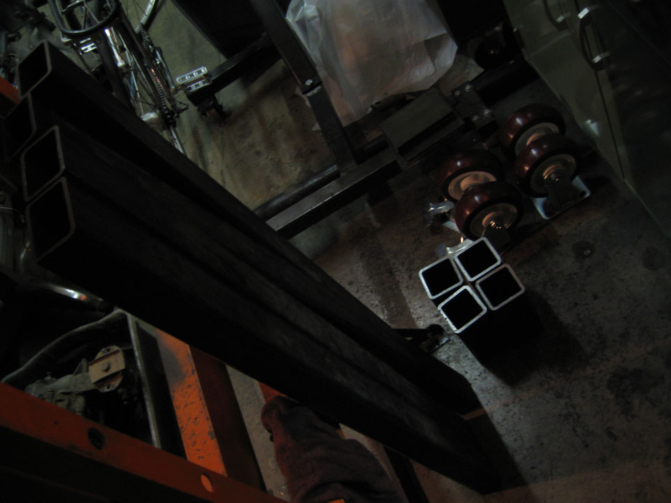

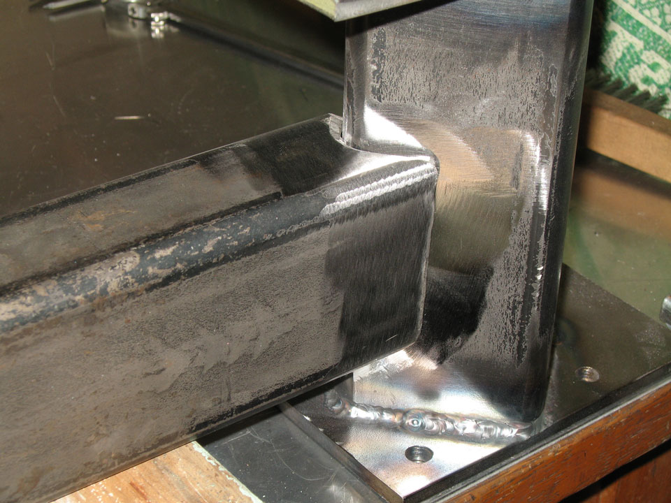

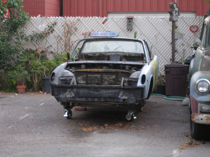

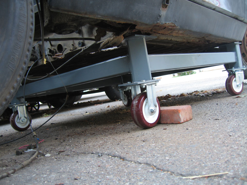

About a week to go here and I think my landlord will be ok if I go long. Unfortunately I don't have the title. I've got 2 bills of sale from the past owners, so I'm going to cut up.
I've been busy preparing. I've got a reciprocating saw ready (IMG:style_emoticons/default/ar15.gif) and i've built a dolly. Once the donor is in pieces and the 420 car is more stable, I will put it on there as I need to be able to move it around to go forward.
Here are some pics of the dolly construction.
(IMG:http://www.914world.com/bbs2/uploads_offsite/www.914club.com-11782-1314420902.1.jpg)
