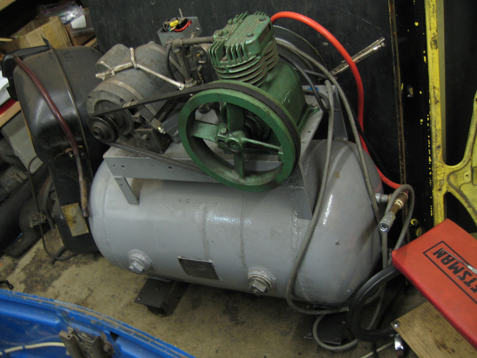

Other progress, I upgraded my air compressor. I'd got this old old Westinghose/ homemade jobber from some guy off craigslist a few years ago and I'd been working it to death with the blast cabinet. It is I think a 35 gallon. I'd been thinking about getting something better.

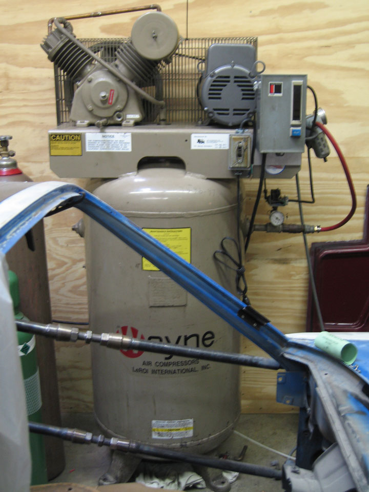

...so I found this on craigslist, got it from a tire shop in huntington Beach.
(IMG:http://www.914world.com/bbs2/uploads_offsite/www.914club.com-11782-1314422026.2.jpg)
80 gallons, dual stage goes up to 175psi. It is actually made by the same company as the old one, as Westinghouse was bought by LeRoi, which actually makes this for Wayne. It is the real deal. The sort of overkill that I'd been looking for seems to come only in 3 phase, and so it was quite challenging to get it hooked up to work with single phase 220 power. I found a 5hp Baldor 220 single phase motor on eBay. It was not cheap, though I guess it could have cost a lot more for a new baldor motor of that size.
Anyway, this new compressor is a beast. I regulate it down to 90psi for the sandblast cabinet, and I can say that it does not EVER get below that. I can blast continuously and it will meet the demand. If I give it half a chance it will actually catch up and turn off.
I'd thought that the shortcomings of my cabinet were a lot due to it being not the recirculating type, but it is working a lot better with this bad boy, like it puts out a stronger 90psi than the other though I'm using the same gauge!. (IMG:style_emoticons/default/biggrin.gif)
