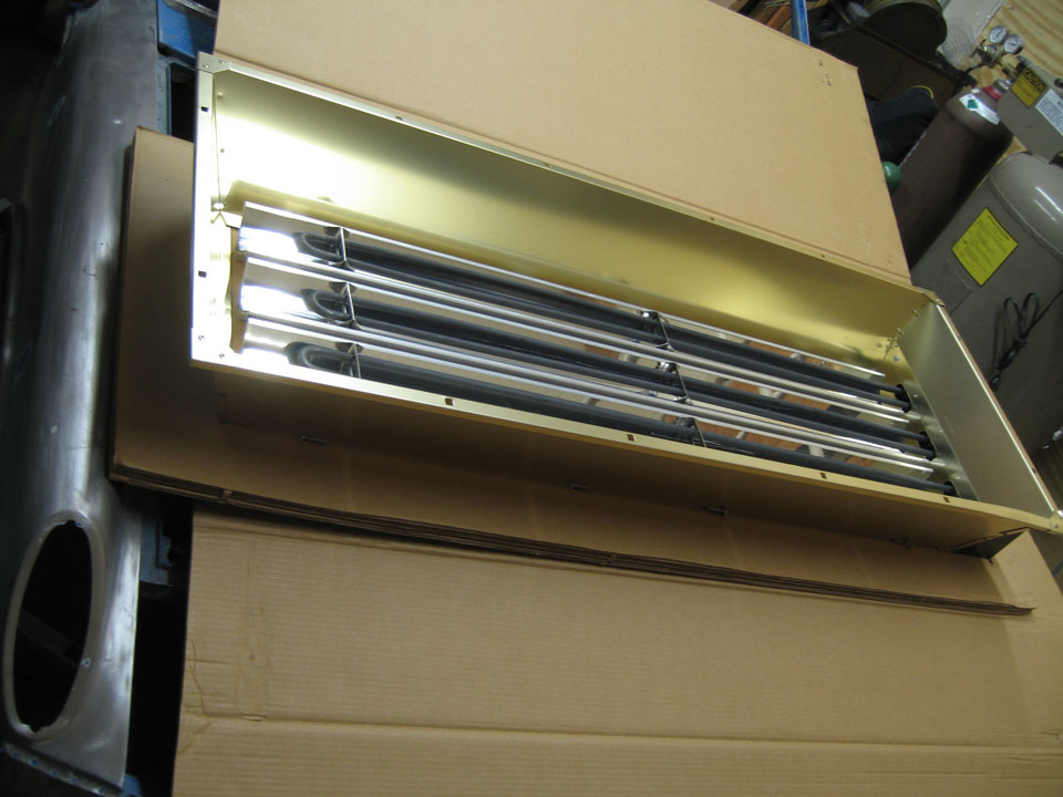

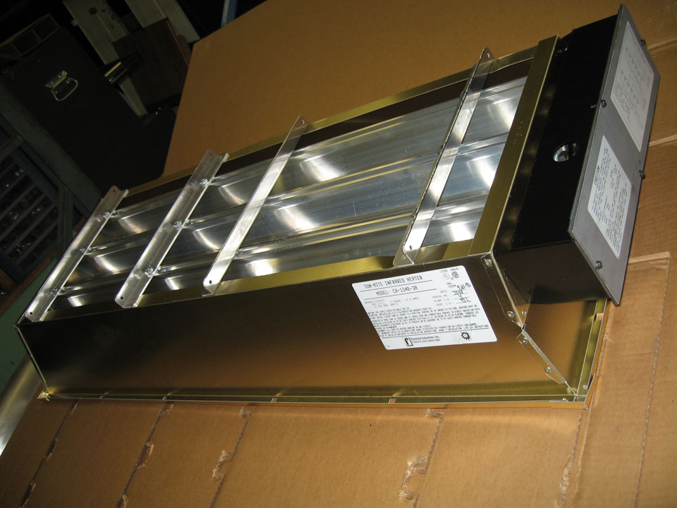

I've got some other 3 phase/ single phase stuff to figure out. It's a little easier than the motor as a heater can be wired in different ways. This crazy thing was actually out of a Chrysler plant. Running it single phase 220 will make it less effective than the 480 3 phase but it should still be quite effective. I've read that getting the paint to off gas is the secret to a professional quality paint job, either by waiting between coats or by baking. I've read that they go up to 400 something degrees at the factory, where paint shops will heat panels up to 150 or so.
(IMG:http://www.914world.com/bbs2/uploads_offsite/www.914club.com-11782-1314464255.1.jpg)
(IMG:http://www.914world.com/bbs2/uploads_offsite/www.914club.com-11782-1314464255.2.jpg)

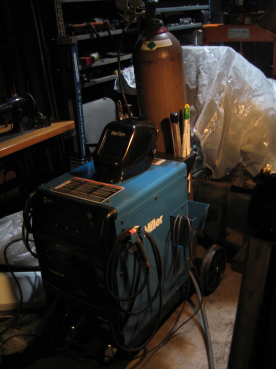

Wiring costs get pretty up there with this high amperage stuff. I needed to move my welder across the room. I ended up making my own 50 amp 20 ft extension chord and it cost me $250.
I broke down and got the runner kit for it which is ridiculous in its construction. The welder weighs 300 lbs and it's held to the rear wheel assembly only by 4 1/4-20 bolts into the sheet metal. The rear wheels look like 5 lug Fuchs though so it's worth it.
