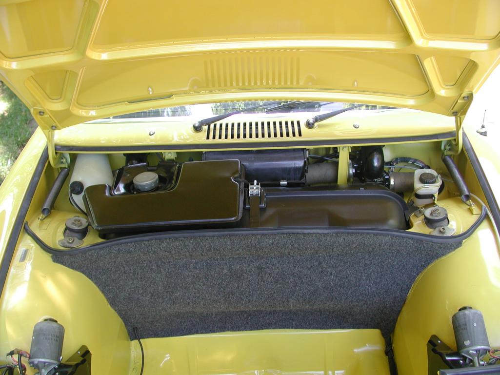

1970 Neun vierzehn   Not all 914s had a charcoal canister. This, from a...   Aug 26 2011, 09:24 PM

1970 Neun vierzehn   the '70/4 is a 49 state car, built date 01/197...   Aug 28 2011, 06:00 PM
