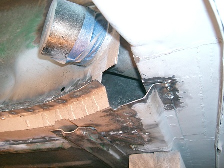

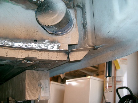

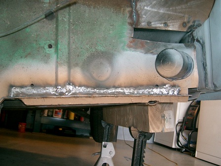

Finally got my new inner long welded in with doubler plates on all seams. Verified the incline of the new long with an incline gauge (with the car level) following Jeff Hails build thread. Door operates well! Entire inner long has been coated with rust encapsulator.
Still have a long way to go but I am hoping that this was the toughest part.

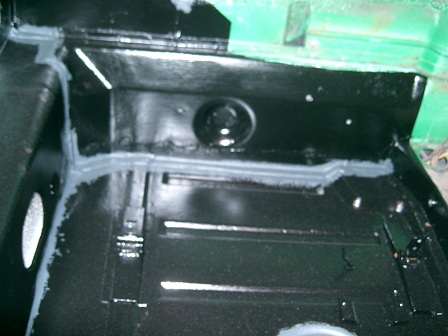

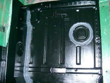

Finished the rear passenger side floor pan on the inside. Two coats ospho (on rusty areas) followed by two coats rust bullet (again, only on rusty or pitted areas) two coats rust encapsulator and new seam sealer. It was nice to look at a small section of the car and say "this is done." (IMG:style_emoticons/default/biggrin.gif)

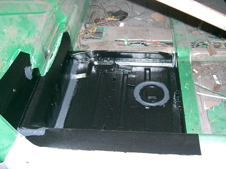

The jigsaw puzzle that is the rear floor pan on the passenger side continues to get pieced together. It became very complicated trying to make this part all in one shot, so I decided to go with a section at a time and weld it all together:

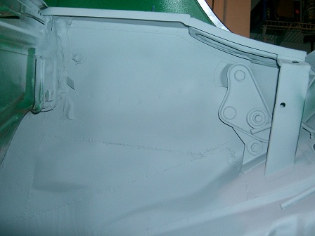

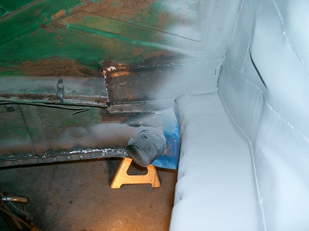

Experienced some cracking after applying the initial primer on the upper wheelhouse. I suspect it is from over-doing it on the rust converter, as I have run into this before using the product. From now on, I will only apply one coat. Wire brushed affected areas and re-sprayed primer:

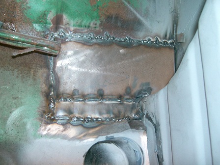

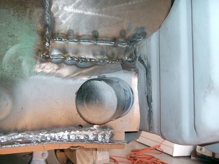

saigon71   My welding skills have improved significantly, but...   Sep 4 2011, 05:22 AM
FourBlades   Great progress! :trophy: You are getting t...   Sep 4 2011, 11:38 AM

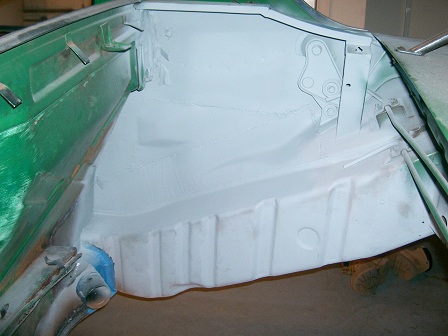

saigon71   Shot two coats of primer on the rebuilt pass side ...   Sep 5 2011, 07:04 PM
Cairo94507   Very nice work; you should be proud.   Sep 5 2011, 07:19 PM
